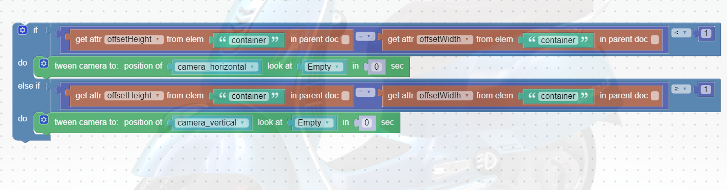

    You can set different camera position for mobile, vertical/horisontal screen and any other situation using puzzles, like it done in scooter demo.
    Here you can see that position of the camera changes accortion to screen orientation.
    To scale your your interface better to use css rules that set different size for each UI elemts according to screen size, like it done in each of our demo in the sdk.

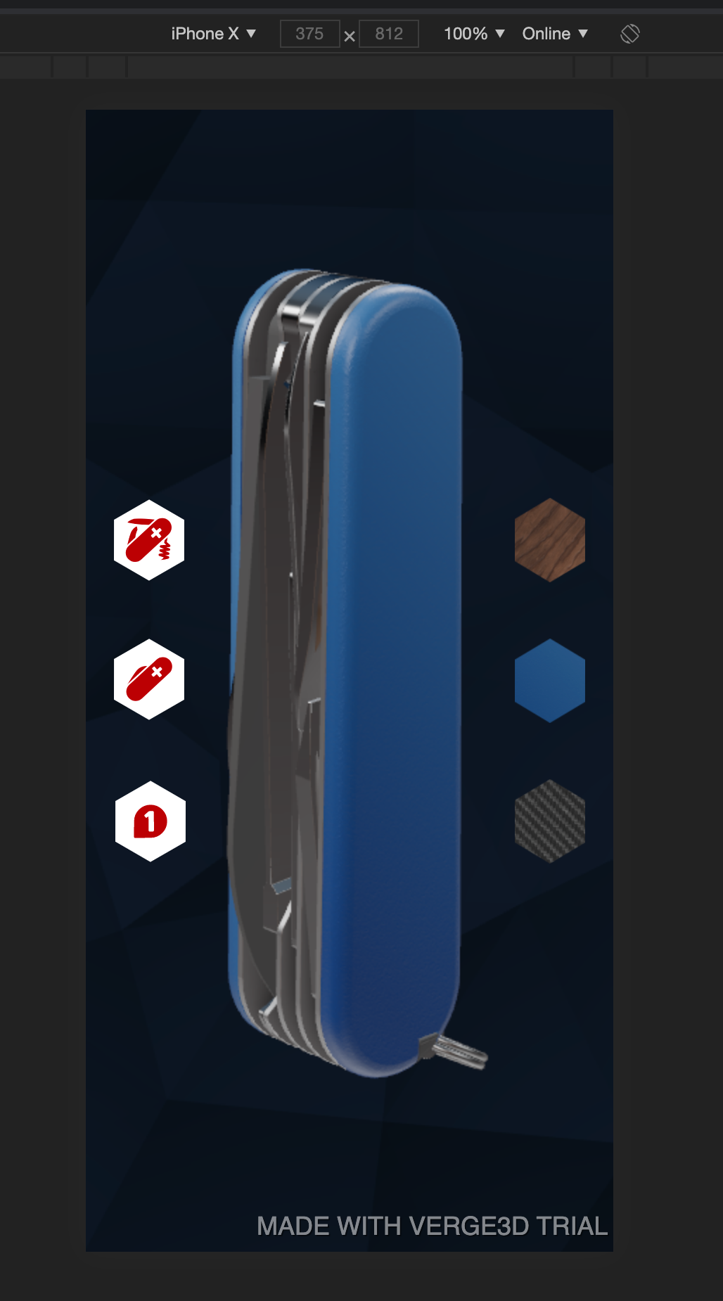

    I set the “Sensor Fit” on the camera to vertical like the pocket knife tutorial suggests, but this didn’t seem to do the trick.
    My scene is not reacting to Mikhail’s solution either. The container you’re targeting; Did Verge create this within html of the scene like scooter.html? Because I can’t find the class “container” in any of those files, could you explain how this works?

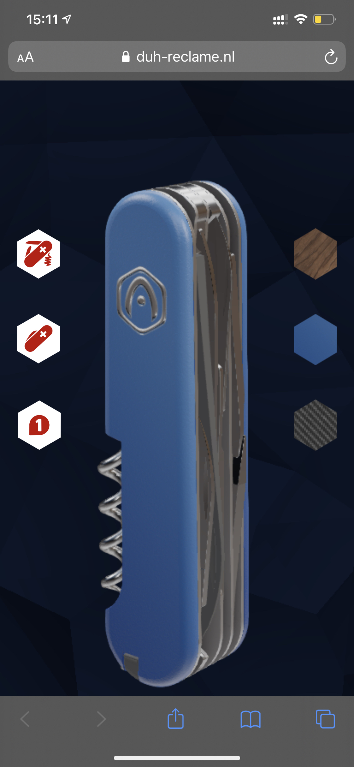

    I added some screenshots. On my Google Chrome inspector preview it works fine. On my iPhone 11 pro max it adds a Safari control overlay on the bottom of the page which seems like the issue making the VH larger and there for not positioning my scene or buttons in the center on a mobile device cause this is an overlay.
