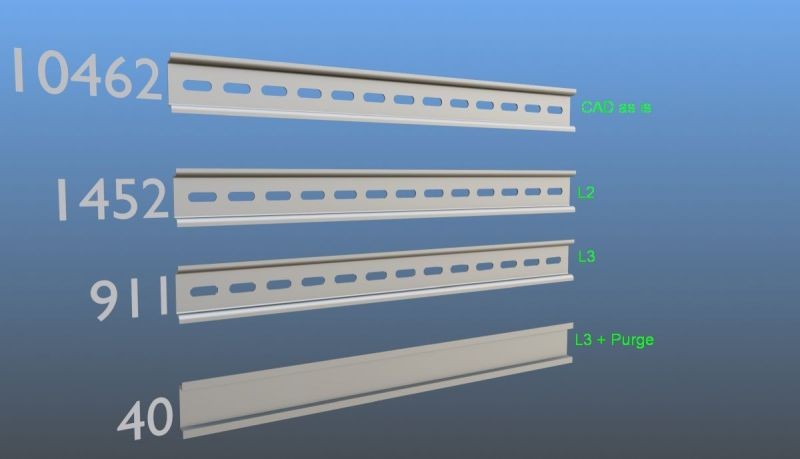

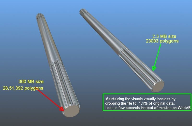

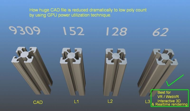

2024-07-12 at 3:27 pm #75879
visualizerCustomerLevel3 is highly sophisticated approach towards reducing mesh count by using pure gaming low poly experience. Its advanced level of working on LOD for gaming asset creations. No AI shit. Its purely human experienced lol. The file size exceptionally reduces and loading time is very fast.
Its fun really sometimes to achieve some impossible results.
for reference here are few screenshots of worked things in recent past.
This is mainly used for LIDAR scan data to convert in 3D model assetAttachments:
