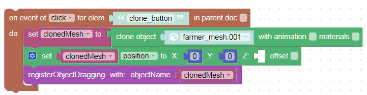

ParticipantThis link affects … click events
Looks like you clone an empty (or appended scene) with meshes as children. In this case the empty (scene) is cloned and renamed but children are not renamed (although they are cloned too). You should clone meshes themselves. As for unique materials for clones you can use this puzzle.

2023-10-30 at 6:38 pm #68078kdv
ParticipantHow can I check what exactly
You can use the console log for debugging…
materials are linked in any way?
No. With the
materialsoption enabled
they can be independent like here.Puzzles and JS coding. Fast and expensive.

2023-10-31 at 5:20 pm #68097kdv
ParticipantSee no cloning at all, only appended scenes
Cloning with puzzles looks a little different…
