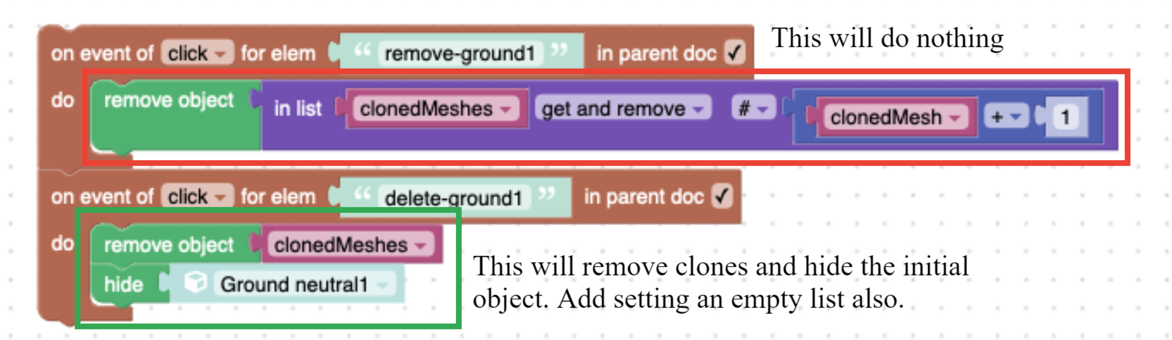

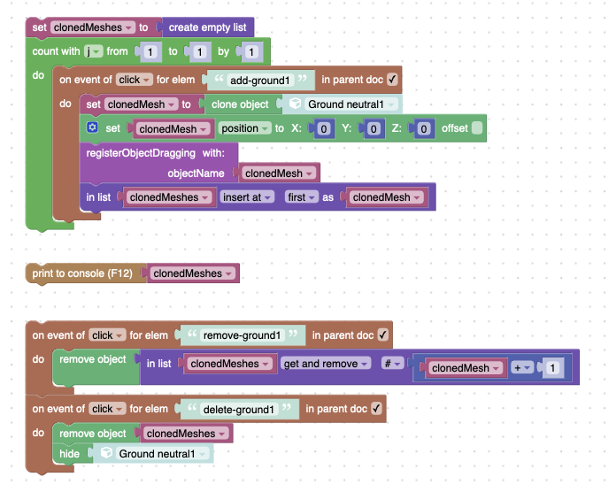

ParticipantHey, I habe a weird problem with hiding my objects when clicked on a html button. The button “delete-ground 1” is revealed by hovering over a dropdown menu icon. It should remove all cloned objects in one list (which works) and also hide my main object, but it doesn’t hide it.
When I let another button (that is not revealed by hover) hide my object it works fine. Does anyone have a solution for this or knows if the hover interaction I did in webflow is interfering with hiding my object?Attachments:
2024-01-11 at 8:55 pm #69627kdv
ParticipantclonedMesh + 1?
What do you expect to get when summing a string value (the last clone’s name) and a numeric value?
2024-01-12 at 9:52 am #69630alissa
ParticipantBut my main problem is that it doesn’t hide the initial object. It just removes all clones. When I tried the same thing with another button that has no hover effect assigned in Webflow it removed all clones and deleted the main object. Do you know why?
Don’t I need the numeric value? It works with removing the clones one by one.
And why do I set an empty list?Thank you for your help!

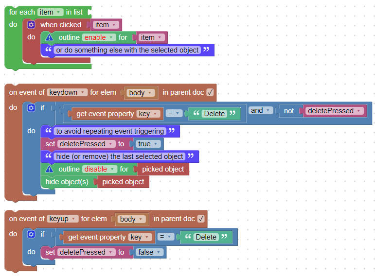

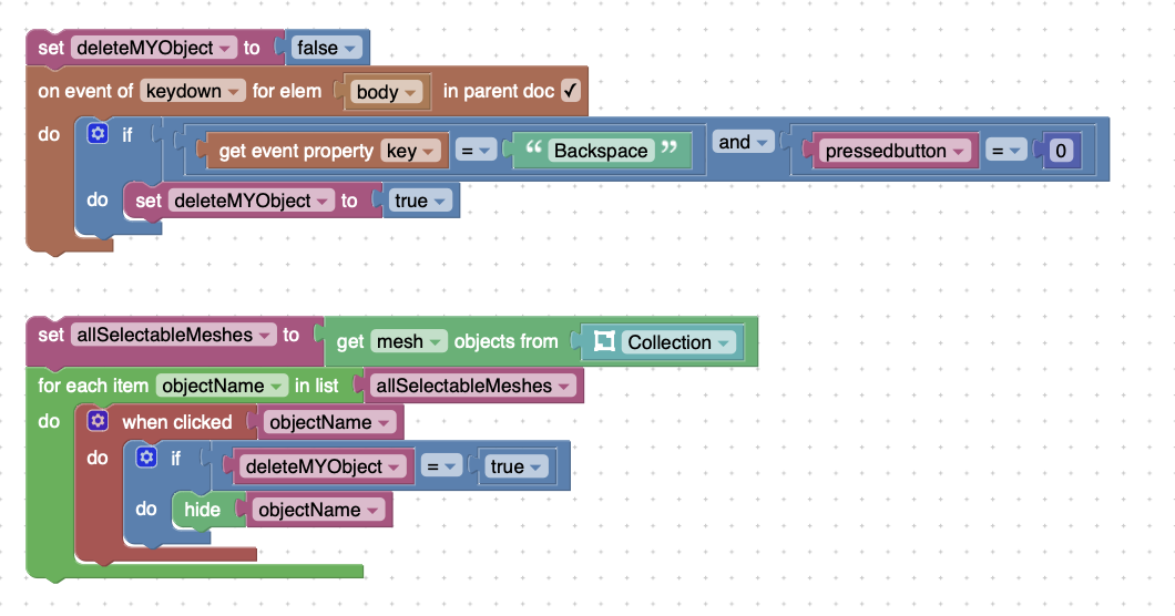

ParticipantActually I wouldn’t need the button, if I can delete any of my objects with a shortcut. Right now I have something wrong with my logic and maybe you can take a look. At the moment they get deleted when I click on them after pressing the shortcut but I want to delete an object when pressing delete on the keyboard.
2024-01-13 at 12:54 am #69640kdv
Participanthow I can share it here?
Export your page in Webflow and put the exported files into the app’s folder. After that you can work with your app locally and can upload the working app to the Verge network.
This will remove the last picked object when the
Deletekey is pressed

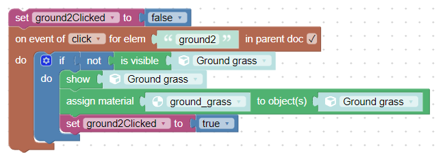

ParticipantThe button “delete-ground 1” is revealed by hovering over a dropdown menu icon. It should remove all cloned objects in one list (which works) and also hide my main object, but it doesn’t hide it.
The reason is very simple: you draw
+,-andxover the main button. Clicking on the main button shows the initial object. When you click onx(it will hide the object) you also click on the main button (it will show the object). As a workaround you can use a zero delay.
And there is no need to use so many variables as
clonedMesh2,clonedMesh3etc. You can re-useclonedMeshas many times as needed. It’s just an auxiliary variable.Puzzles and JS coding. Fast and expensive.

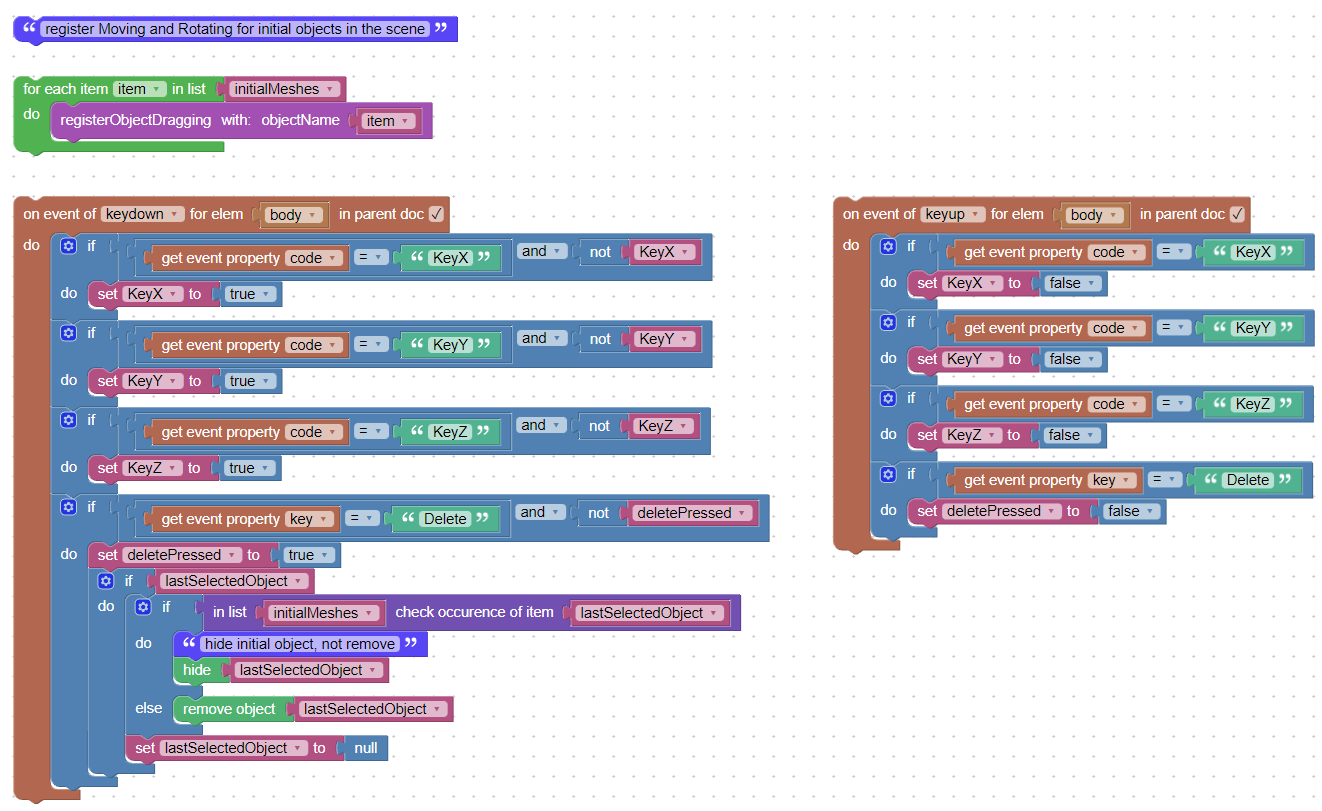

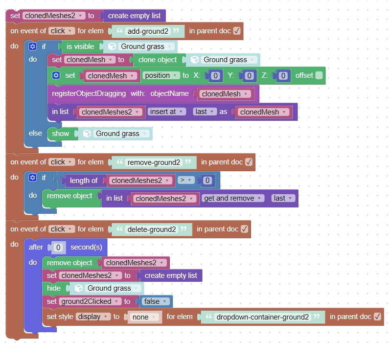

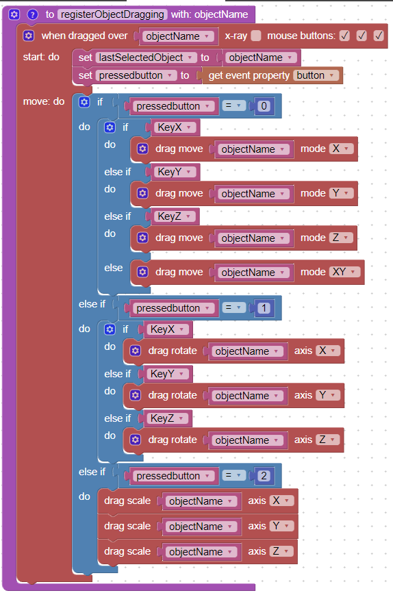

Participant2024-01-14 at 1:27 pm #69667kdv
ParticipantToo many changes to be made. Take this modified logic (the first four ground buttons) and do the same way for other buttons.
