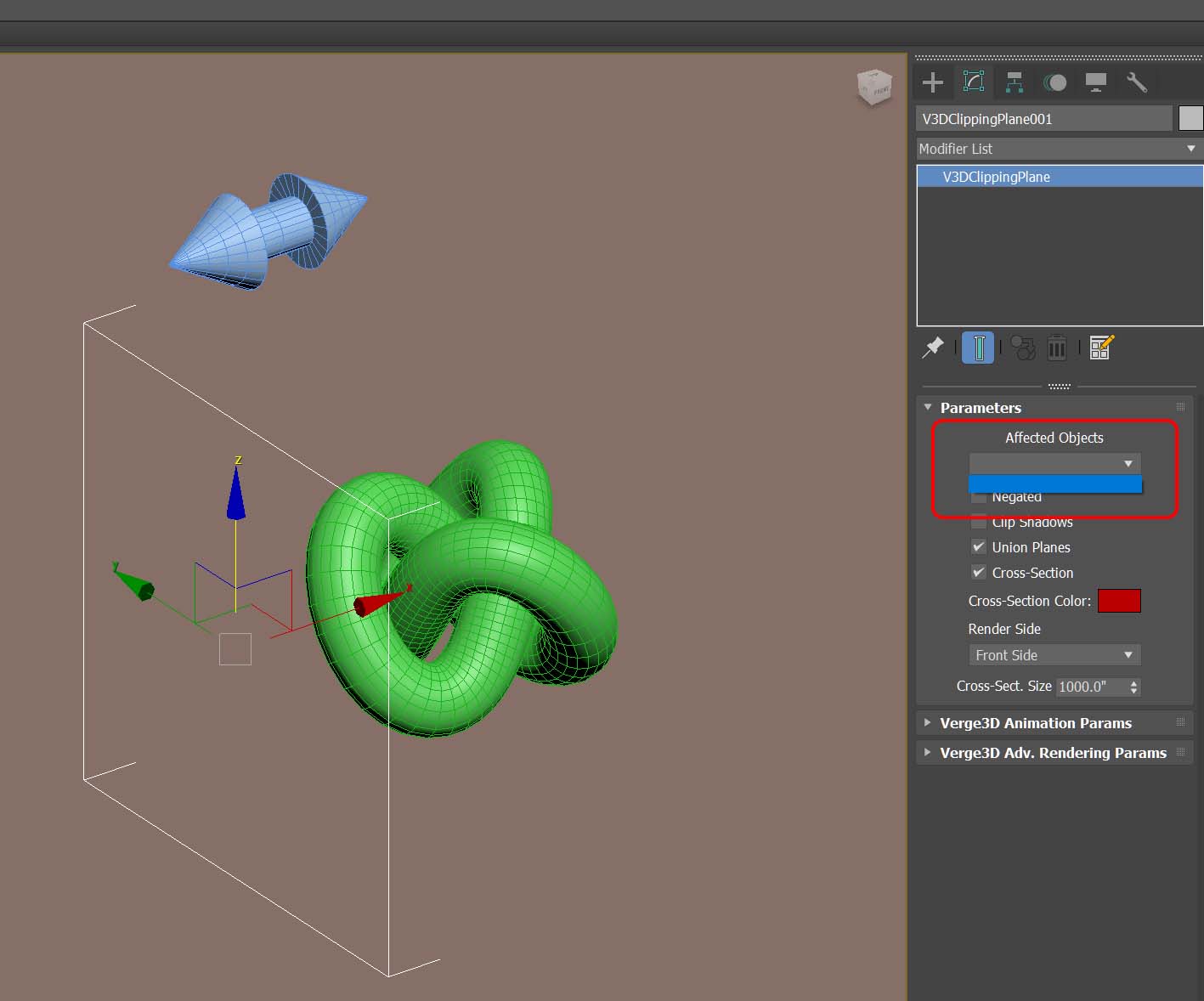

    When I open the dropdown for “Affected Objects” I get an empty list. Does anyone know how to populate the list?
    Currently, its applying the clipping plane globally, so my arrow is being affected when I only want the torus knot affected.
    I’ve referred to the V3D clipping_planes example, but still cant seem to find out how “body” was added to the Affected Objects list.
    Cheers!
    Chris

    You need to create a Lesection Set, put objects in it and choose it here in Affected Objects.

    Thank you! :good:
