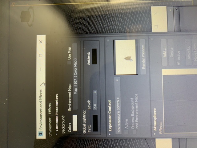

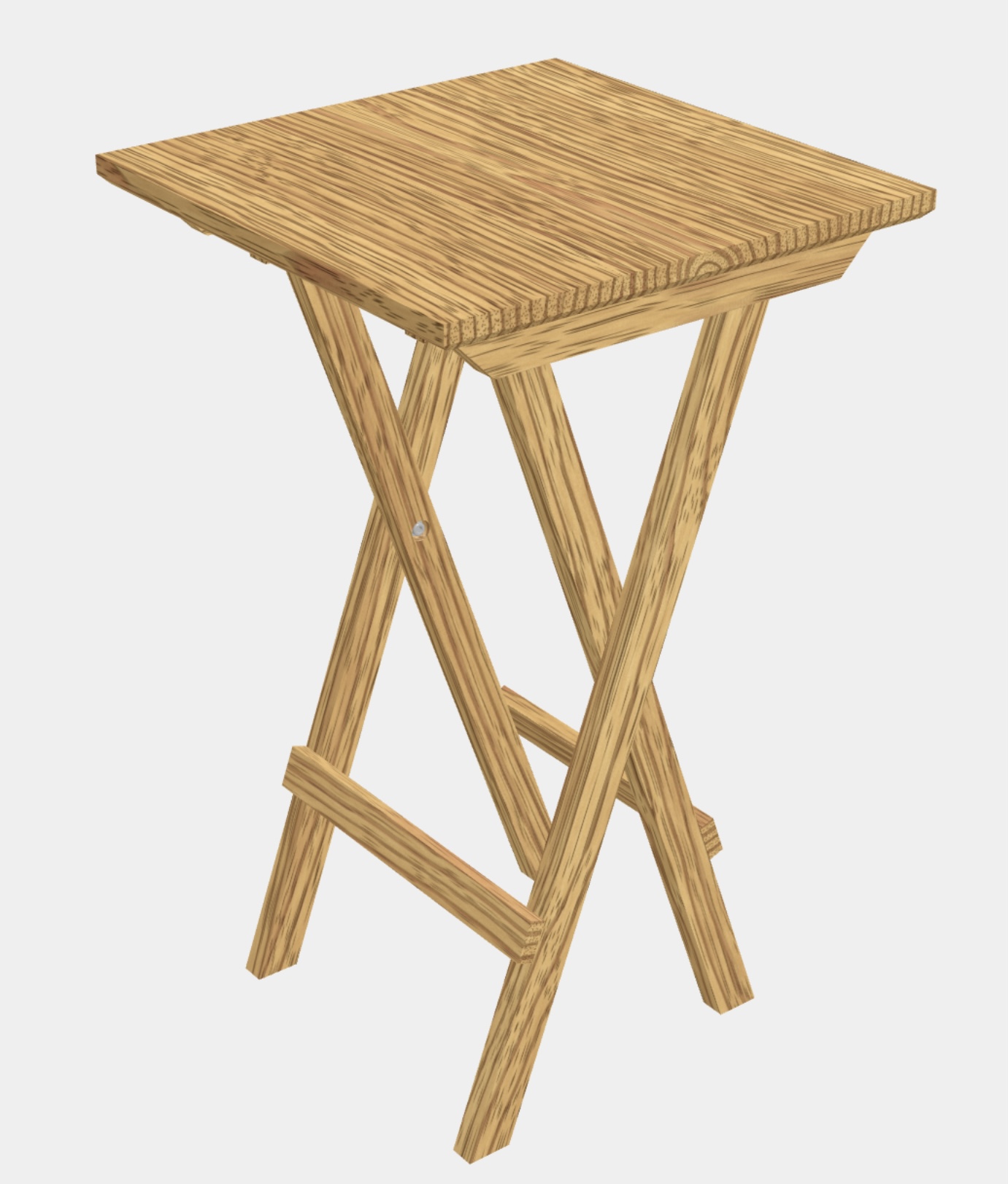

vernCustomerGlobal lighting does not work at all in the 4.0 pre1 build. Any changes doesn’t affect the scene in Verge3D. Also in previous scenes from 3.9 that are opened in 4.0 pre1 show lighting that is super super bright (pretty sure it has to do with the global lighting).
Definitely a bug since it works perfectly in 3.9 right? I also attached some pictures.

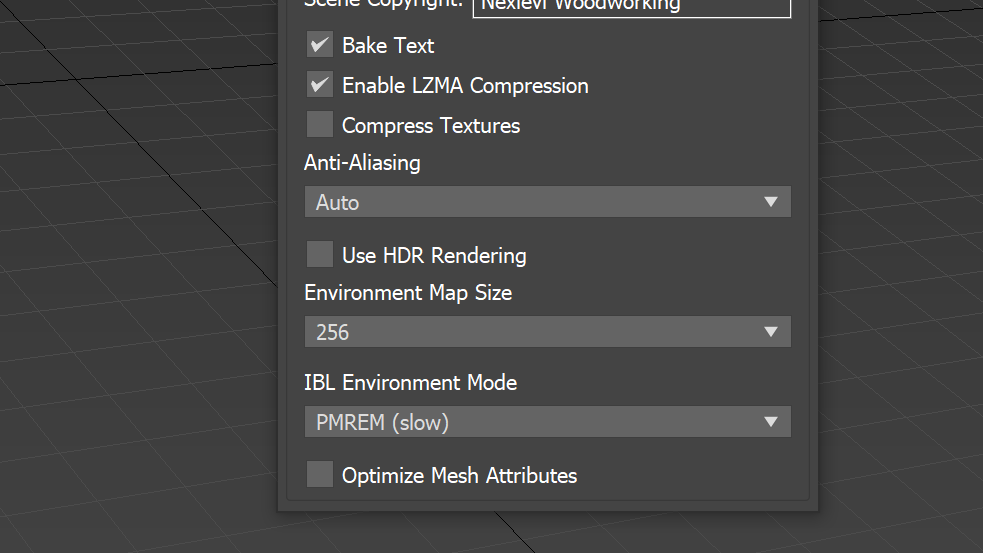

Alexander KovelenovStaffHi,
Checked your file. Looks like you disabled specular lighting by using Light Probe (Fast) as IBL Environment Mode. This is an over-optimization feature for really slow devices. Please use PMREM for more correct lighting (see screen attached).
Regarding Tint value, we do not support this feature since in does not supported in Physical renders (like ART or Arnold). So it should be always set to 1.

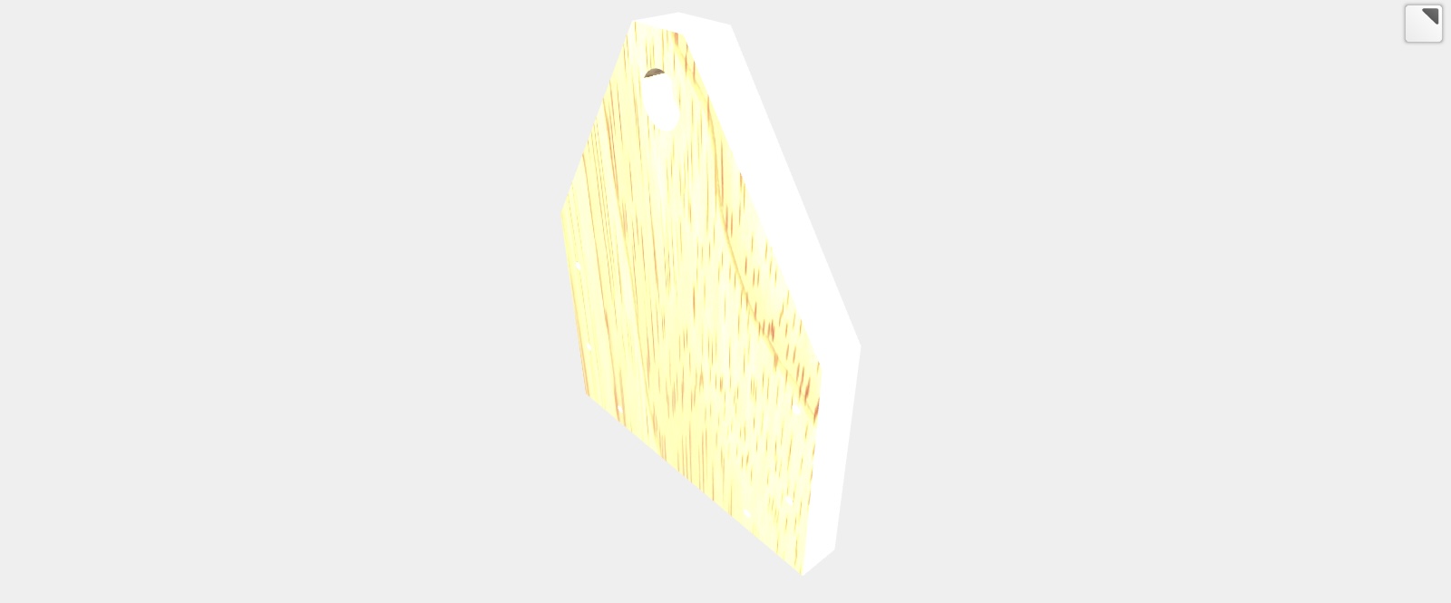

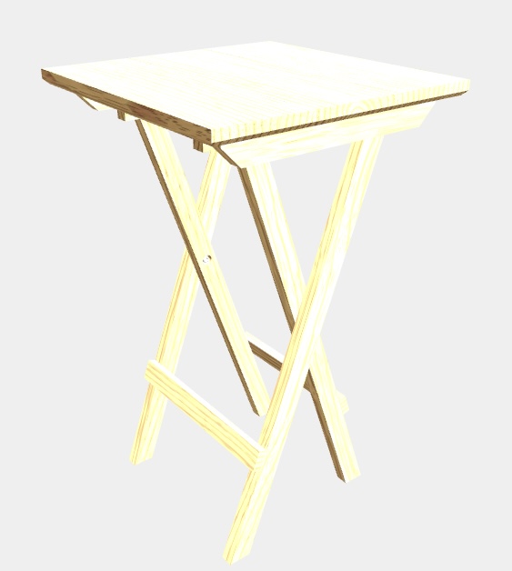

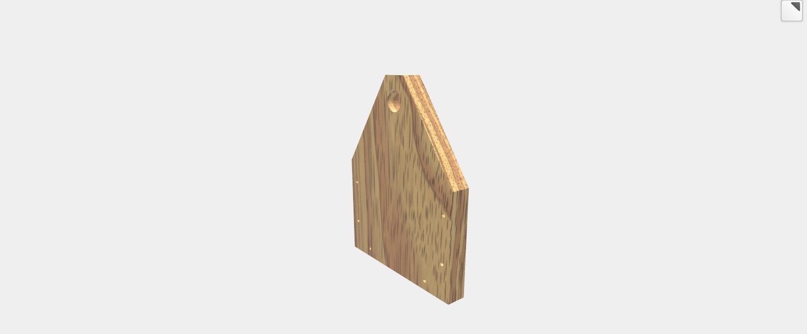

vernCustomerSo I tested it using all 3 IBL Environment settings and it doesn’t change my lighting at all.
All I want is to use a color background and to use environment global lighting, just like I was in 3.9.If I do not add actual lights into my scene and only use environment lighting, the entire scene has an insanely bright (high intensity) light that I can’t adjust. You can see what I mean in the first attached image below.
If I add actual lights to my scene (instead of using environment lighting) than I can get the lighting better as you can see in the second attached image.
But I need to use environment lighting for performance reasons and I can’t use it at all because of the aforementioned issue.Can you please tell me how to get the normal environment global lighting back, just like it was in 3.9 please?
