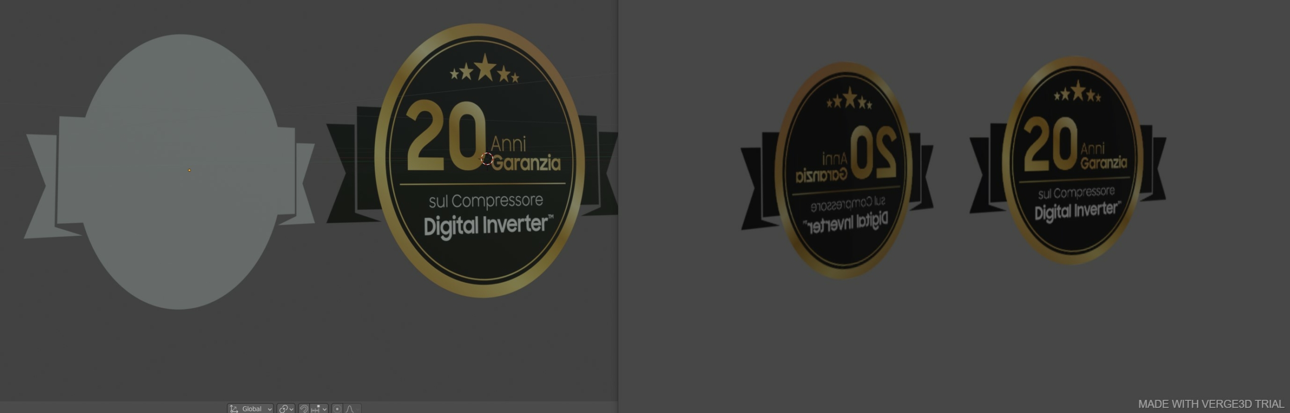

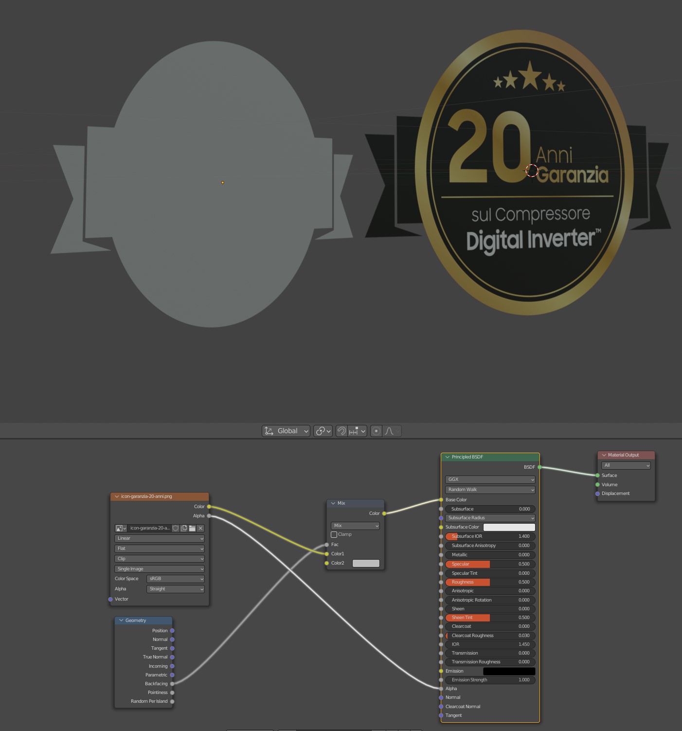

    we’re having troubles with backfacing node out of geometry..
    on the manual you say it’s supported but we cannot figure out how to get it work.
    Thanks in advance.

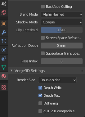

    Hi, it should work. Perhaps you got double geometry or so on this model? Also, did you set “Double Sided” on the material? If nothing happens, please send us your blend file.
    X | FB | LinkedIn
    #55374
    It works, but only when the blend mode is Opaque, Alpha Hashed or Alpha Clip
    Alpha Blend is not supported.

    Confirm that. Thanks @kdv77kdv
    No double geo @alexander-kovelenov
