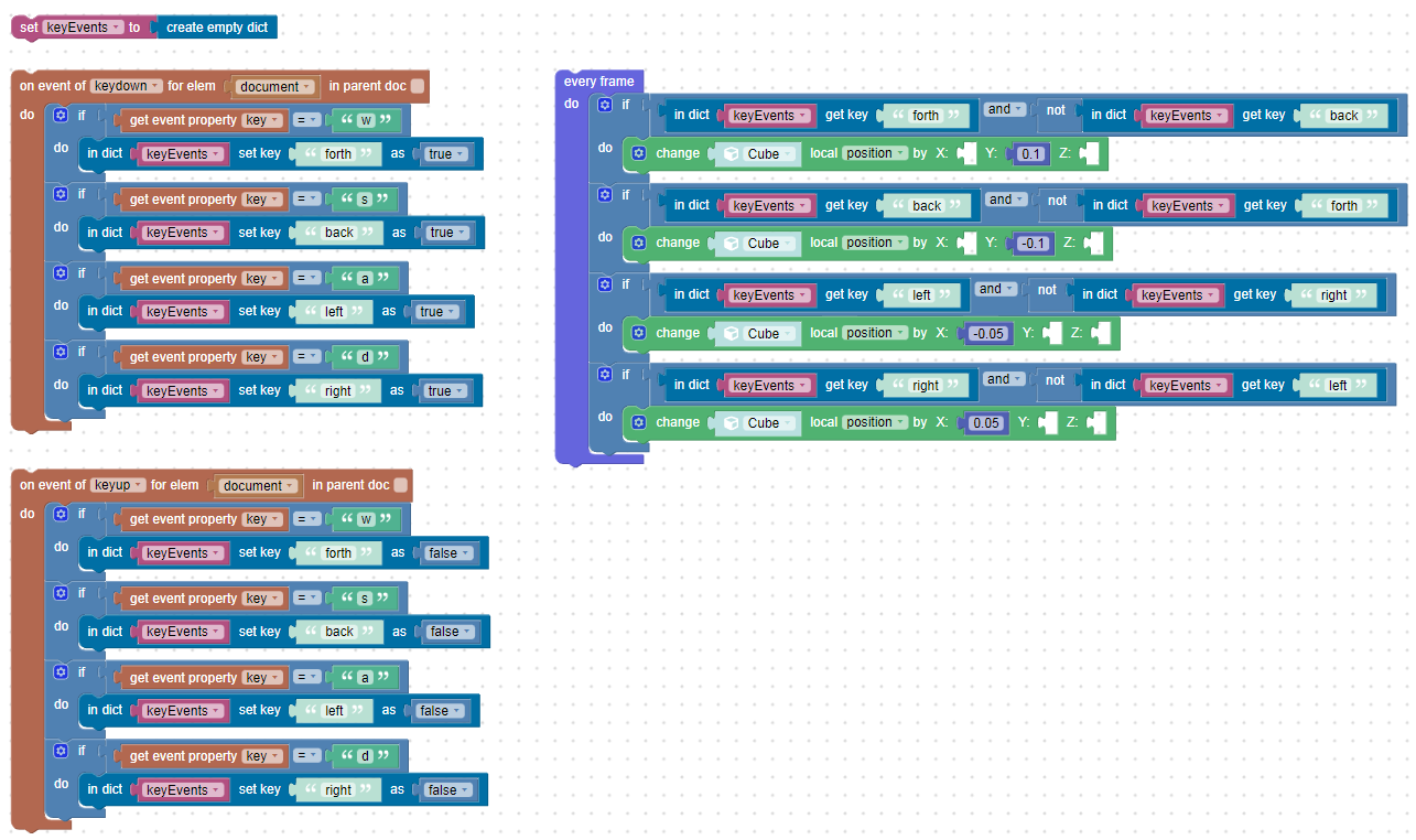

Without logic puzzles you will do nothing.FPS trialproduct 20.9.25 https://postimg.cc/gallery/LMM5vkQ/af43346e

c4ccParticipantWhile kdv must absolutely be credited for teaching me the fundamentals of keydown/up events, here’s the puzzles for keydown/up events for movement I ended up with eventually. Just change “up” to “forward”, and “down” to “back”
Also, assuming you’re using Blender…
speaking of 3d camera view, a la GTA games, the camera has to be moved around together with the playable character via the above controls, too. Here, the puzzles do so:
Meanwhile, in Blender, the camera verge3d setting must be this, so camera may be controlled via mouse:

c4ccParticipantAs far I understood, you are only moving the camera left and right, Isn’t it?
I’m trying to create a character that moves left, right, forward nd backward. So, is it the same method I need to repeat to give forward nd backward cam movement with the character?Yeah, my camera’s moving left and right.
In your case, you want the camera to be controlled gta style.
So your camera must be moved forward and backwards via player controls as well, with “orbit” setting chosen under camera verge3d options in Blender. Apply the puzzles for moving camera left and right to keydown/up events for moving forward and backward, but change the number to Z axis instead of Y axis.

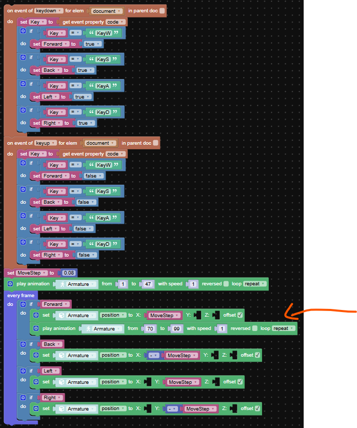

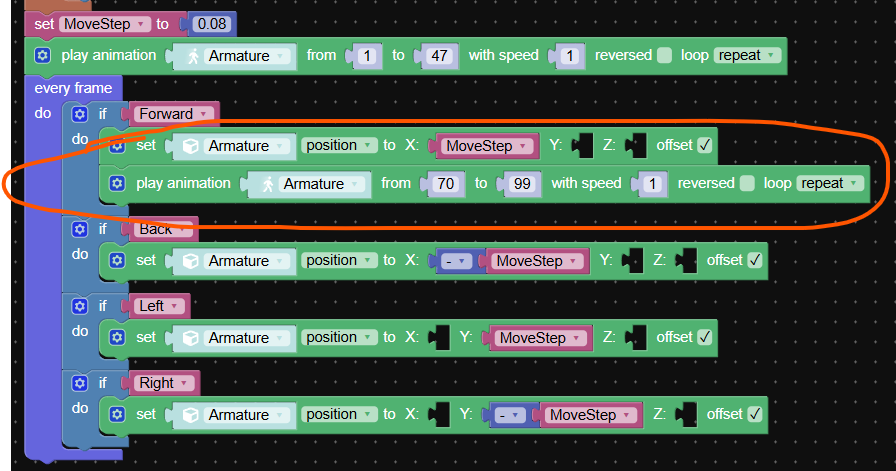

albiParticipantto be controlled gta style.
Example
I want to trigger multiple animations, ie Walk animation when walking and Idle animation for the rest of time.
Unlike the example shared by kdv, I’m trying to trigger the animations when the Keys are pressed, not in the event of clicking any mesh.I have tried as below (PFA) but it’s not triggering the specified animation.
What’s the right way to do this?
2025-01-08 at 6:27 pm #79712
c4ccParticipantRemove “every frame” for your animations
