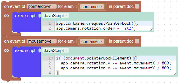

    I have a camera (attached to an object) following a path.
    I’d like to have pointerlock (or something like that, looking around, freely turning the camera) on the First Person camera but let the path control the motion through the space.
    If I use First Person camera directly then it doesn’t follow the path. Instead I’m using the ‘No Controls’ option.
    So maybe there is a way to program the pointerlock with puzzles?
    Does anyone have any ideas?
    #59694

    That works perfectly. Thank you so much!
