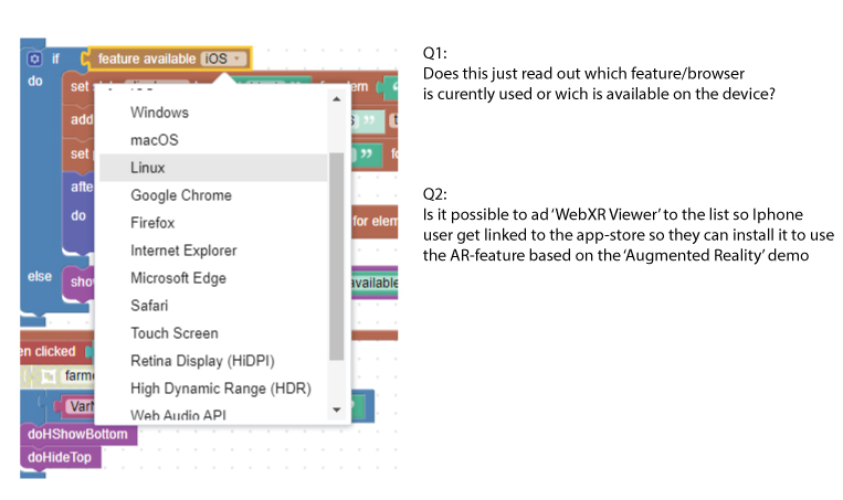

    I’m currently working on a AR-app based on the ‘Augmented Reality’ demo. Works pretty well except Iphone/ios users. Is it possible to read out of the ‘WebXR Viewer’ is present or used? So We can re-direct them to the app-store or to the app???

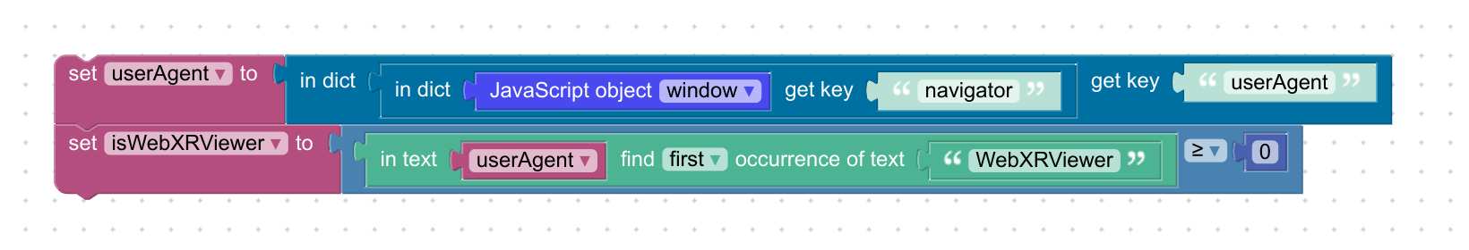

    actually you can do this with puzzles alone:

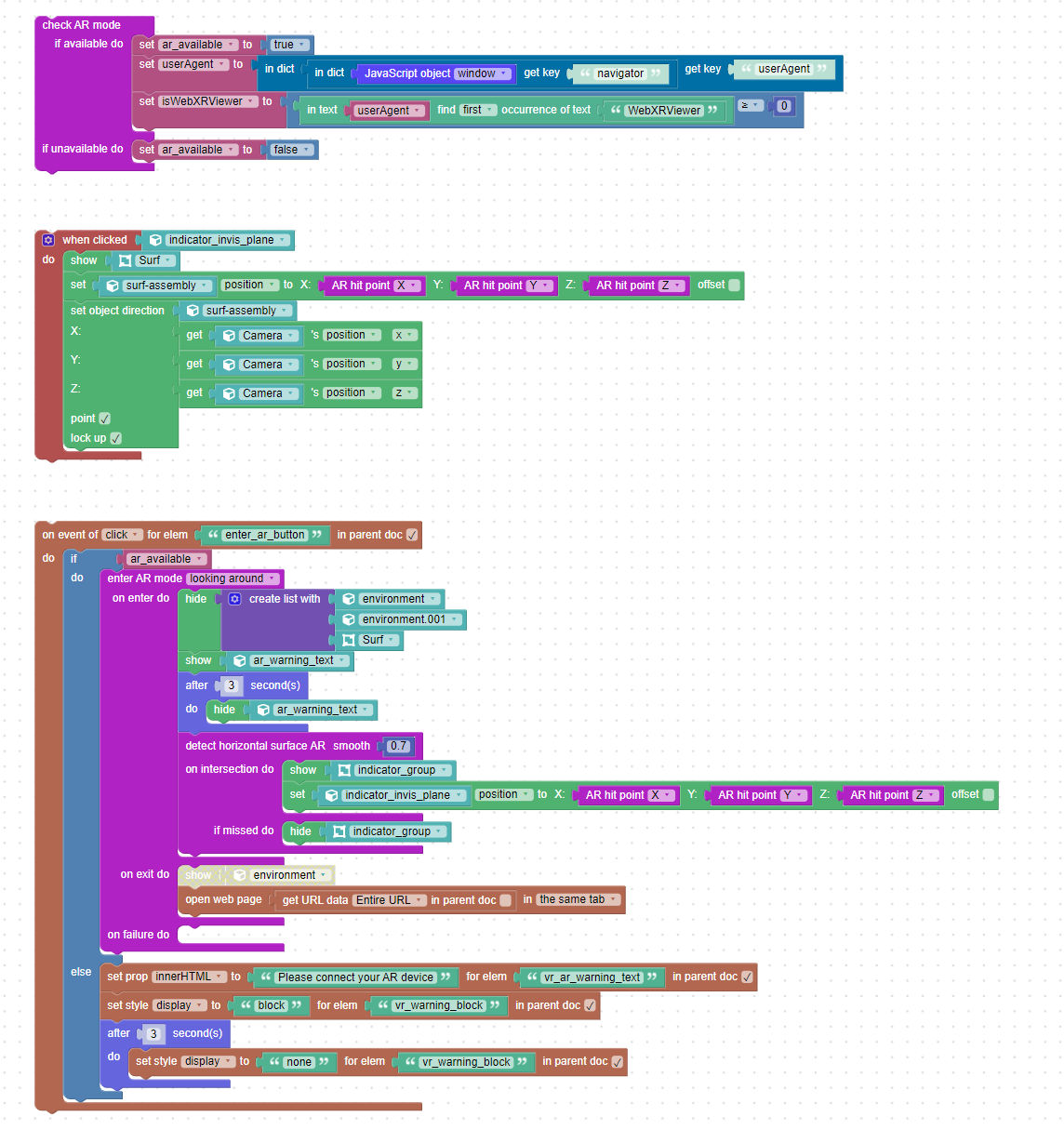

    the puzzles you sent are to put like in my screenshot?
    It work for both, VR and AR on iOS?
