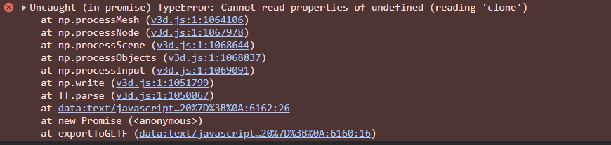

    my configurator uses cloning to generate multiple instances of objects (all objects have new names) . I want to download all visible geometry to a .gltf file. But i get an error in the console stating “TypeError: Cannot read properties of undefined (reading ‘clone’)”
    Is it possible to download all visible object (clones included) to a single .gltf?
    Thanks in advance!

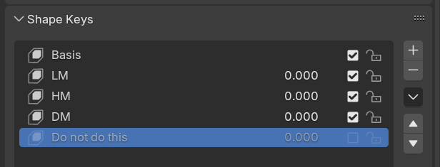

    Solved: do not leave checked off shapekeys floating around. :whistle:
    #81308
    this is actually an issue with Blender addon, we’re going to fix it in the upcoming Verge3D update. Thanks for reporting :good:
