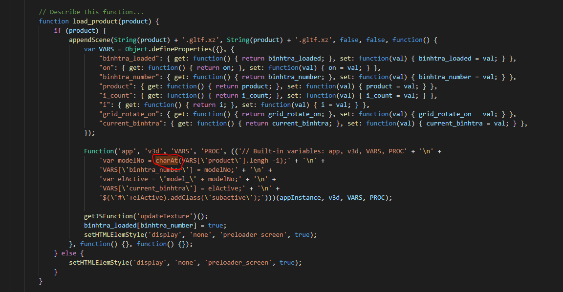

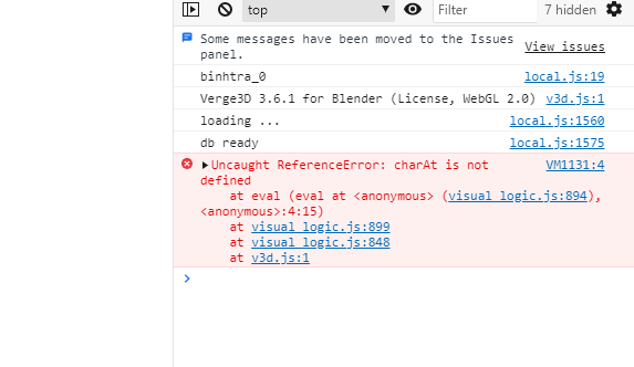

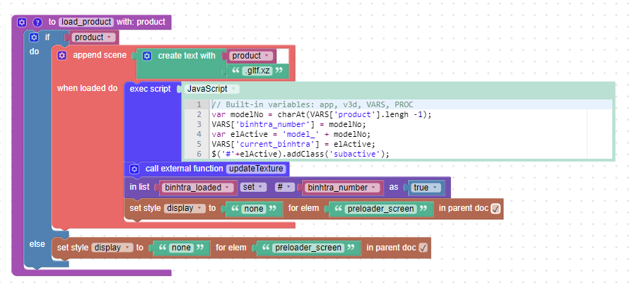

    I have a problem with exec script puzzles, see file attach. Pls help.
    Tks
    #40271
    it seams like there is an issue in your own code. The charAt method should be executed for some string value. Check out here for more info.
