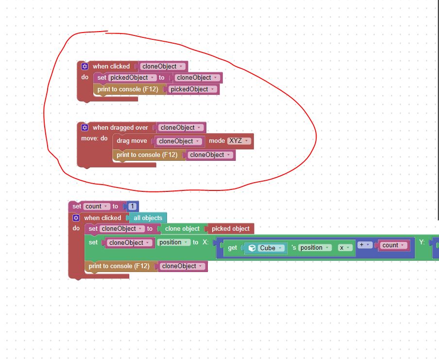

    Hi Yuri,
    Why I use variable for click/picked object not work?
    Tks,

    GlifTek, thanks for your reply. But it not resolve my issue. It not work with clone object.
    Hope anyone to help!

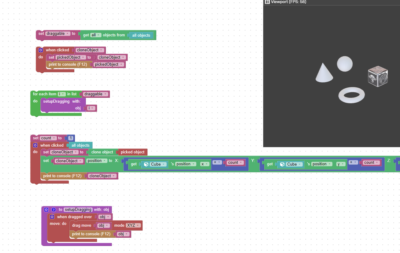

    #41010
    lamthanhle
    Hi, issue was solved.
    How: setupDragging(cloneObj) after call clone().
    Thank you.
