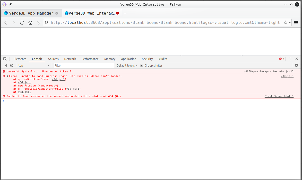

KeikoCustomerI have difficulty to open Puzzles tool since the last update.
My browser’s Inspcetor Cosole says “Unable to load Puzzles’ logic. The Puzzles Editor isn’t loaded.”
(Please see the attached screen shot image.)Where should I check on my settings? Please let me know.

2022-09-08 at 3:14 pm #55671kdv
Participantthe problem begins from
puzzles.min.js. did you changed smth in it?Puzzles and JS coding. Fast and expensive.

KeikoCustomerI re-installed v3d and created a new blank app.
On my Falkon browser, still the same problem exists.
However, I tried to open http://localhost:8668/ on another browser Brave, it’s working fine!I set Brave as default for HTML.

KeikoCustomerI removed Falkon browser and installed again.
Now it works. It’s obviously my old Falkon installation had something wrong.Thank you for your kind replies.
