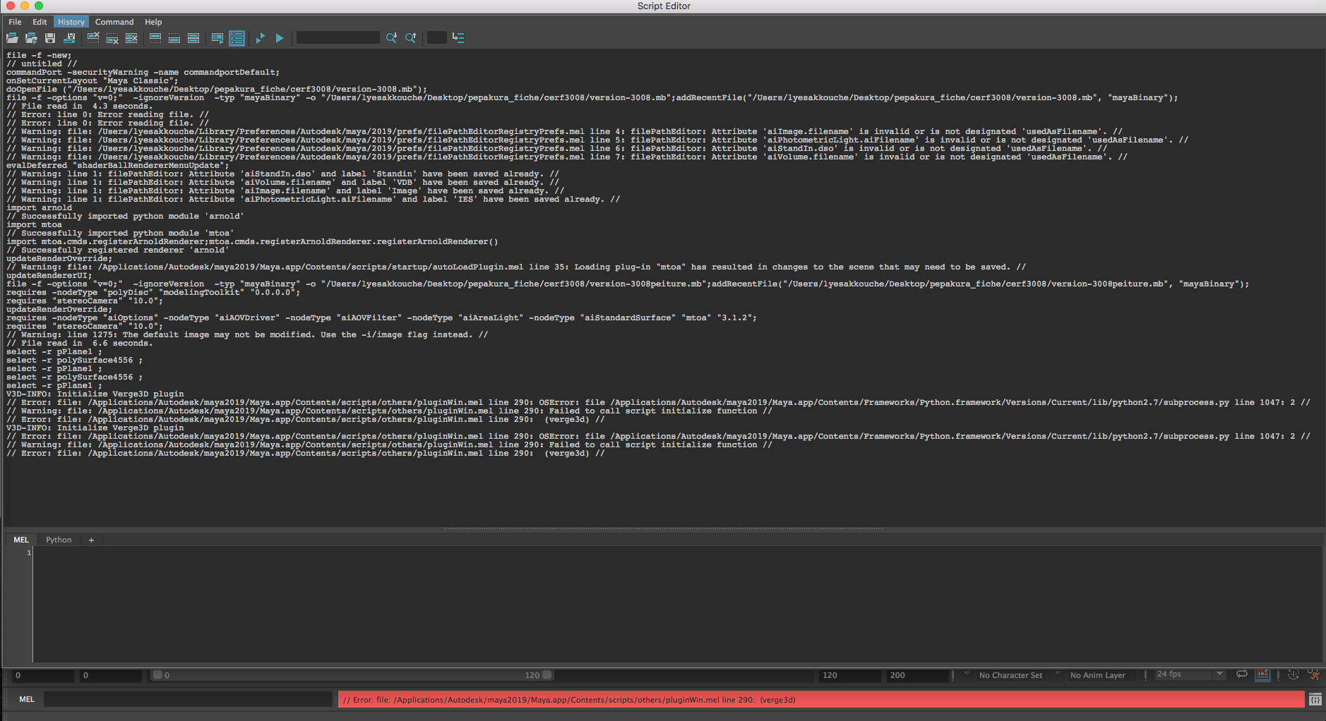

    #32815
    lyes
    Hi , i use Verge 3D 3.3.1 Mac for maya!
    This is screenshot
    Thanks
    #32843
    Unfortunately, we can’t resolve the root of this issue from your screenshot. Please try to install Verge3D 3.4 pre-release to see if the issue persists.
