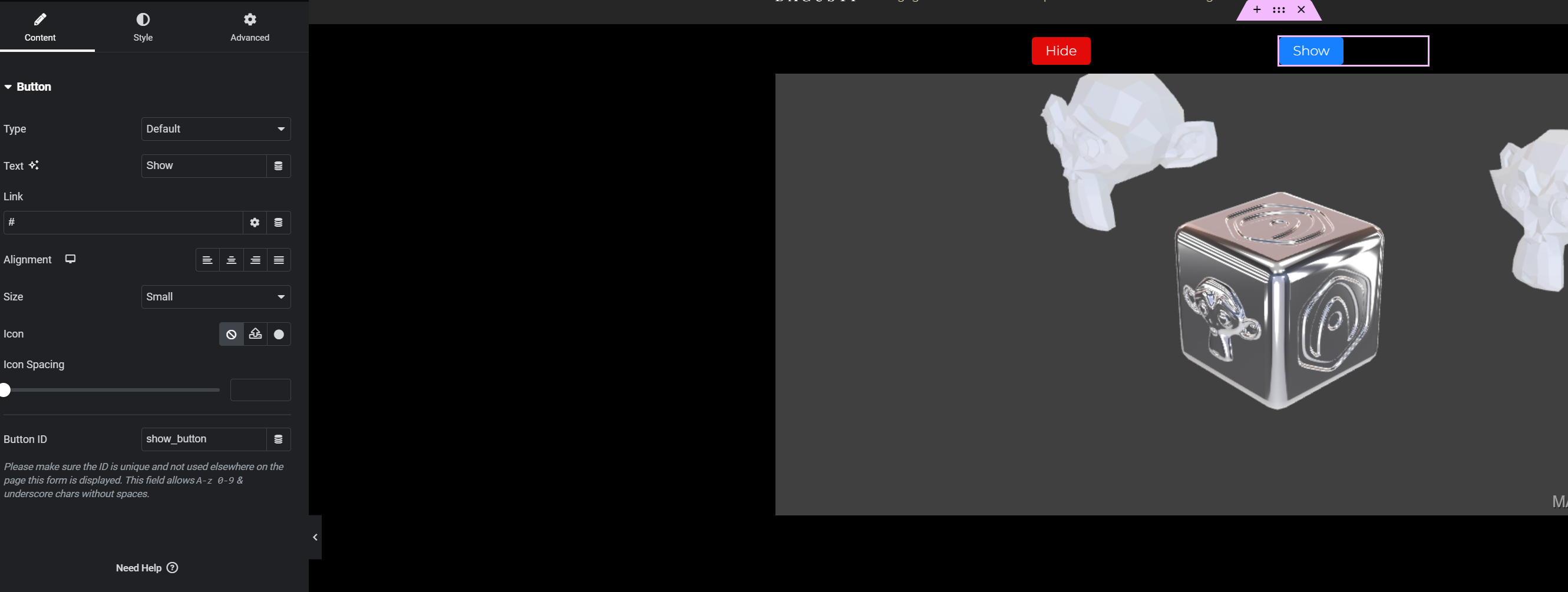

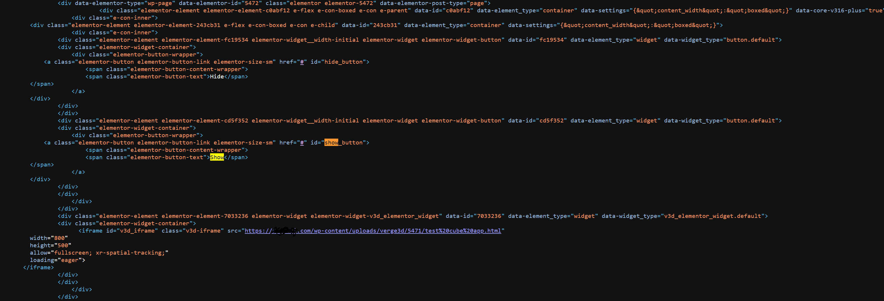

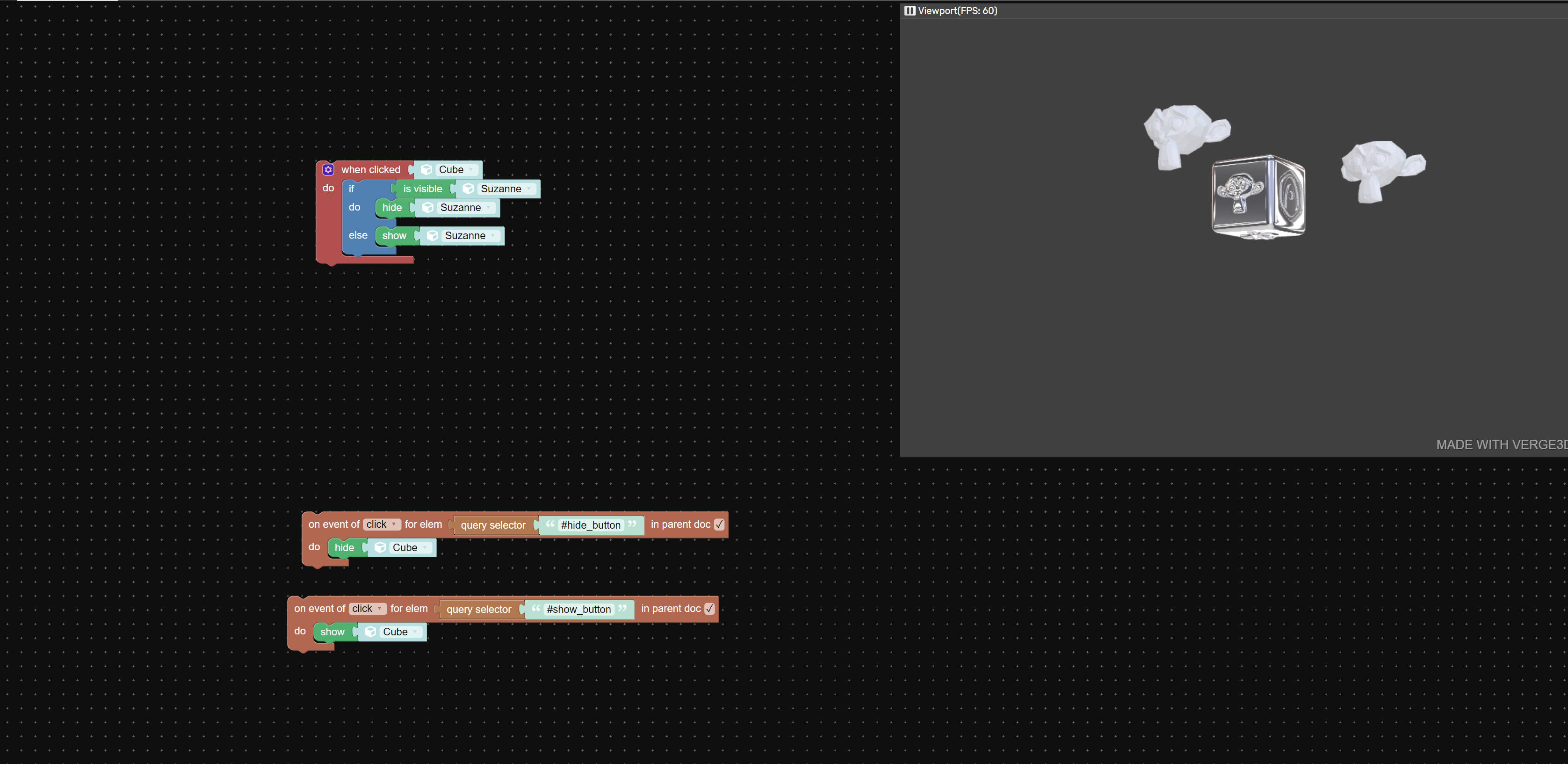

    Hello,
    Having followed all instructions here and in the online tutorials, I am still unable to make the buttons interact with the app through elementor.
    Attached are some screenshots of the id in elementor, the calls in the puzzles, and the output code. All seems in order – but nothing is happening on screen.
    What am I missing?
    Thank you.

    #68408
    You want them to be interactive right in the editor? :scratch: Maybe at least you should go to the preview mode first?
    #68415
    allister
    </blockquote)
    These were configuration views only. I am testing in a separately loading window.
    Apparently it was a cache thing (so even simpler than preview mode ;)). Though it appeared to be a private vs public page visibility for a bit.
    Good job :good:
