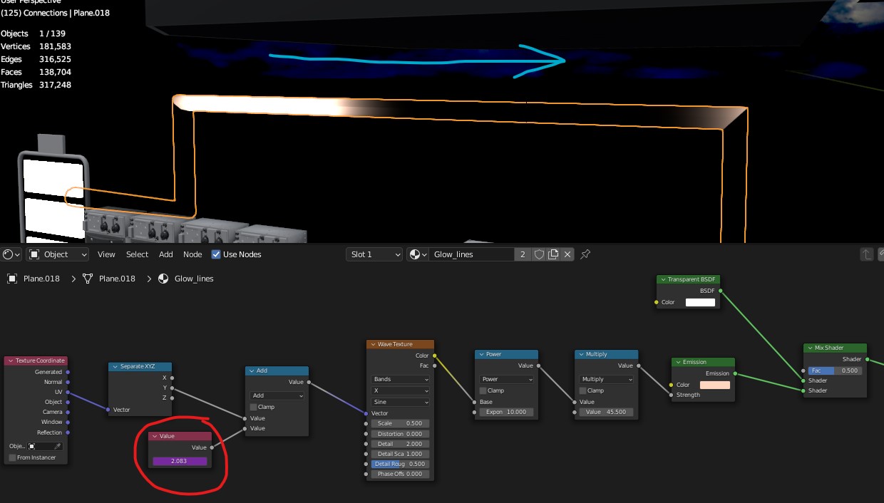

    I need to use driver expression #frame in Blender shader node to achieve some infinite animation loops in shader effects. But it doesn’t work in Verge3D. Is there any way to walkaround this?

    I need to create the “connection lines” that represent the energy flow. I have a thin cylinder mesh, and thanks to the shader from the image below I can slide the glowing effect along it. In the circled value I can type #frame and it perfectly animates the flow in Blender. But unfortunately, it doesn’t work in Verge3D. I also tried to set up this value via puzzle but it requires a number input and rejects the # symbol.

    So what’s the problem? Just animate that Value node using key frames and it will work in Verge3D.

    I know I can do that, but this solution doesn’t create a perfect loop. Also, in other shaders, I would like to use the #frame instead of keyframes, so I’m trying to figure out if it’s possible to use it in Verge.
    The problem with keyframes is that they end at some point. And even if the animation is looped, when the keyframes end and the animation is played again, there is a sudden “jump” in the visual effect (when it comes back to the first frame). I try to avoid this “jump”, so the #frame solution seems to be the best. But I guess I need to find another walkaround unless someone knows the answer on how to use “#frame” in Verge.
    In fact, it’s the worst solution. You’ll have to create a new exporter which will export the inner Blender’s python-based logic for drivers to glTF. And a new glTF importer to make it work in three.js/v3d.js.
    It does
    With the correct end position you won’t even see this “jump”
    https://v3d.net/iqo
    Can you share the blend file? I’ll look what can be done. Unfrotunally w have no plans to support drivers, it would be too complex soluition for such basic tasks like looping animation.
