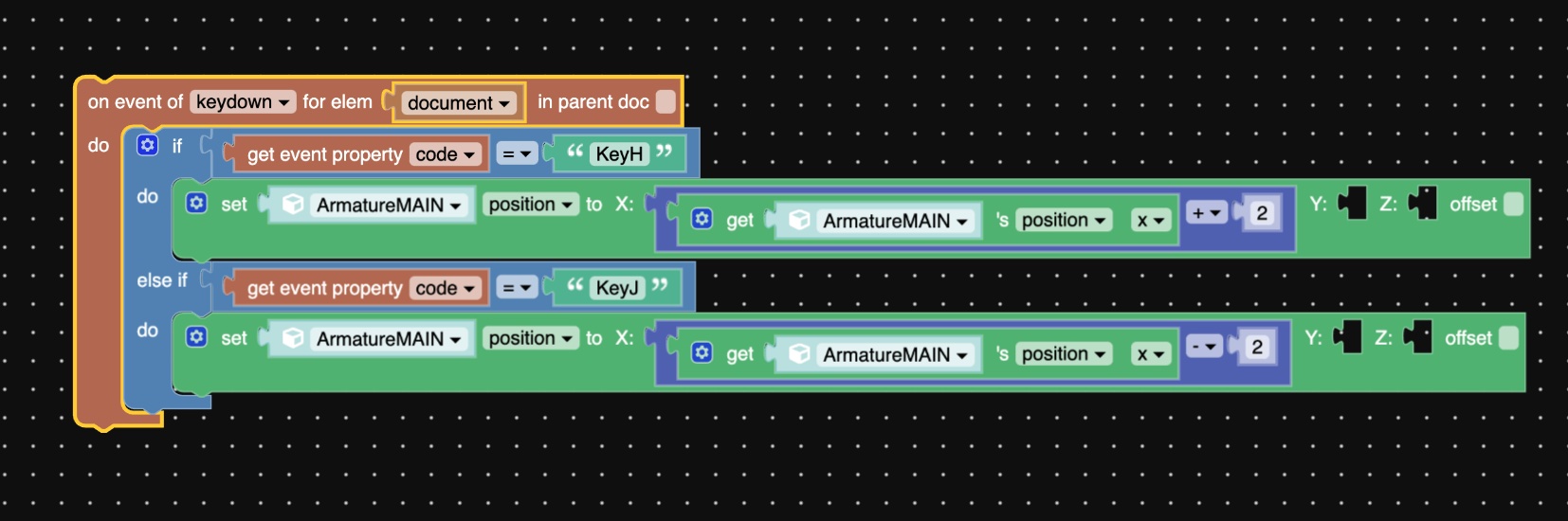

    #76573
    Proof of concept.
    Here is a simple key driven project that moves an armature around directly. No object,no empties…etc.
    Demo : H key moves it in the X. J key moves it in the Y
    https://v3d.net/12bo
    Zip file of project with blender file:
    https://v3d.net/12bp
    #76576
    the issue you are going to have to over come is what the ASDW keys do natively vs what you are trying to add to their functionality. ASDW will move the camera by default.
    So if these are the keys that you have to use….another solution would be needed.
    If you are using a First Person Camera….the commands will work after the camera is moved.
    If you are using No Controls on your Camera the command will work instantly
    If you are using Orbit the ASDW keys other than camera seem to be ignored.
