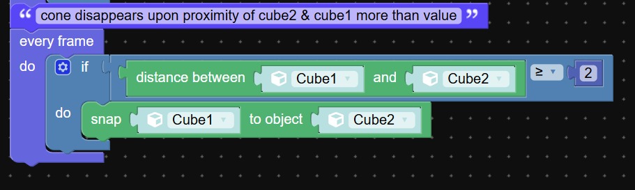

    Hi there, does someone know if there is a tuto/demo of simple Drag and Drop / hover / move / snap? For example a board game or an assemble robot parts…

    This feature can be implemented by comparing the distance between the objects and snapping when the distance is below some threshold.
    P.S. I believe we need to make some how-to guide on doing snapping with Verge3D :scratch:

    Hi
    Fab,
    You can try this.
    I had used this in the past and worked perfectly. This is a basic thing but you can further customize.
    Ignore about the cone thing in text note.
