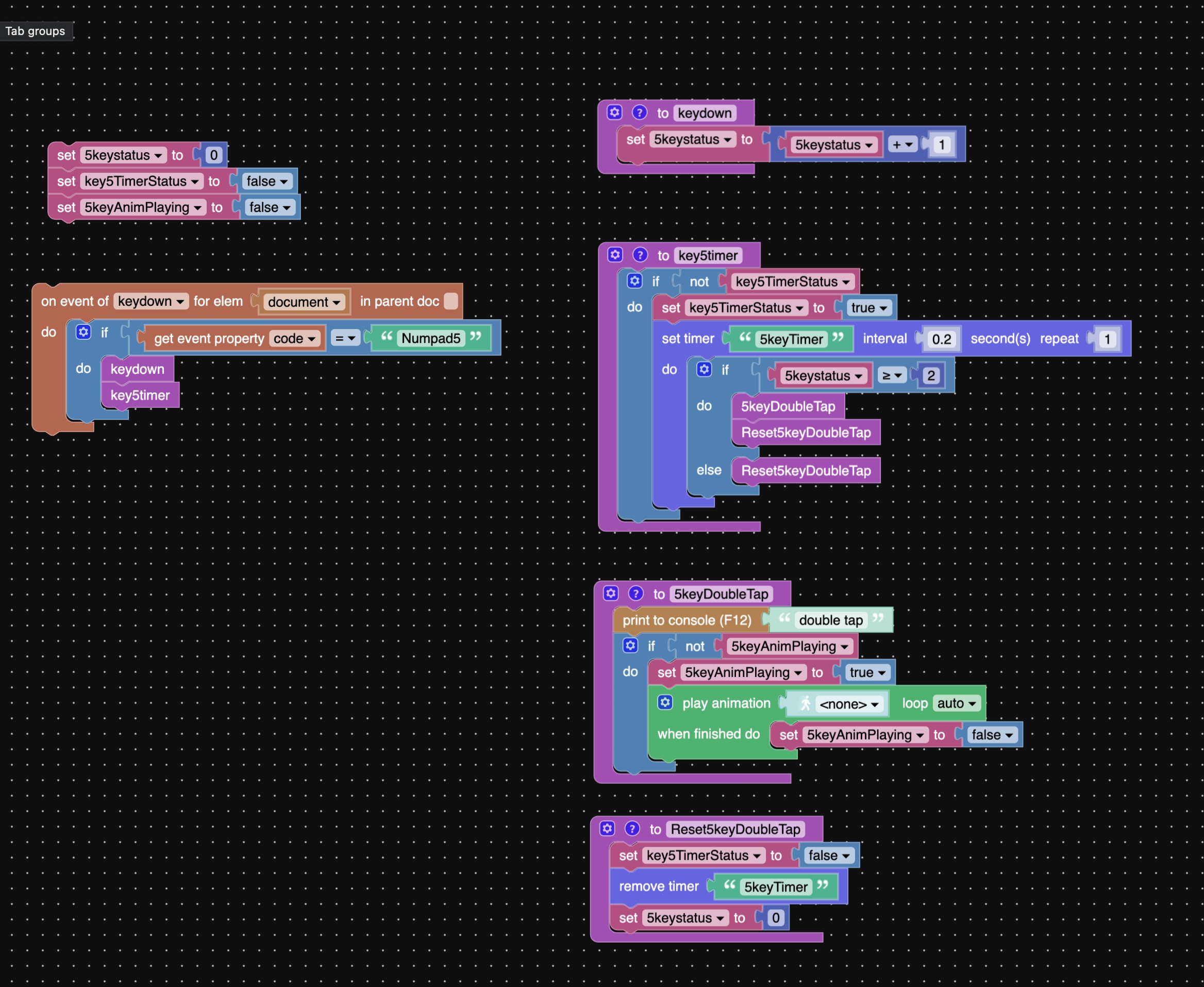

    #79389
    Here is another working sample with the 5 key.
    Single tap makes the cone rotate.
    Double tap will make it jump while rotating.
    Project file located here with blend file: https://v3d.net/16e9
    Demo located here: http://localhost:8668/applications/X3L_double_tap_key/X3L_double_tap_key.html
    Open the demo in developer mode and monitor the console log so you can see when events fire.
    Try out the puzzles with a simple animation similar to what I have provided. Validate its working the way you want…Then switch the animation so something more complicated.
    If it fails with your animation then you have to determine why….is the animation you are playing consuming too much memory…fps low… whats causing it to not fire properly.

    c4cc
    Yes, technically, this does work, but I’ll need to make a couple minor tweaks first. Thanks again for this
