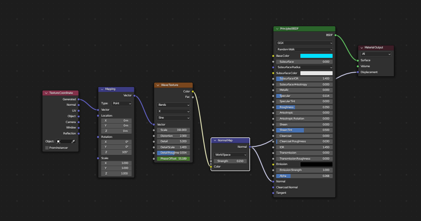

    Show your shader.
    #68549
    PLAN8
    #68553
    This won’t work. The Displacement output is not supported https://www.soft8soft.com/docs/manual/en/blender/Shader-Nodes-Reference.html#Material_Output
    Use the Displace modifier. It works.
