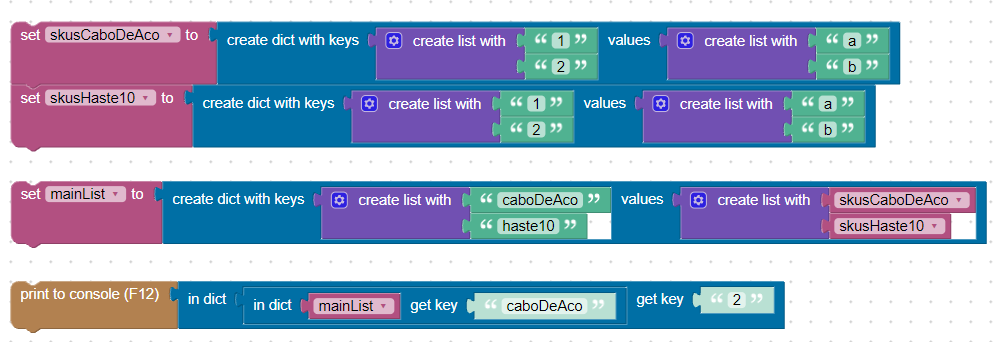

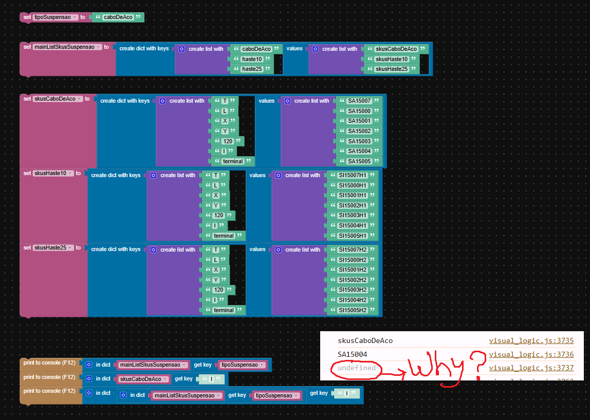

    Hi guys, I’m working with a few dictionaries to set variables dinamically on the application, but I’ve come across an issue that I can’t understand. If I try to get a key from a dictionary whose name is determined based on another dictionary and another variable, it doesn’t seem to work. I’ve successfully done this before, so I’ve replicated what I did, but now I can’t get it to work.
    I realize my explanation is kind of confusing, so I’ve attached an image to better illustrate what I mean.
    #79268
    Why? Because you’re trying to read a key from a string value.
    #79276
    Brameister
    So obvious, yet I didn’t catch it. Thanks for helping me see that, kdv!
