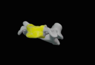

    It is kind of difficult to see, but my some of my textures have cracks running through them but then when you zoom in the cracks disappear. Does anybody know what this is?

    you might try using wider margins when baking your textures. See more info here
    http://wiki.polycount.com/wiki/Edge_padding

    That seemed to help a little, but did not get rid of them, maybe I can’t put enough padding on???
    I also might try revisiting the material to see if there is an issue there.

    If it not helped try to add more padding and bake maximum margins as possible in 99% this solve a problem.
