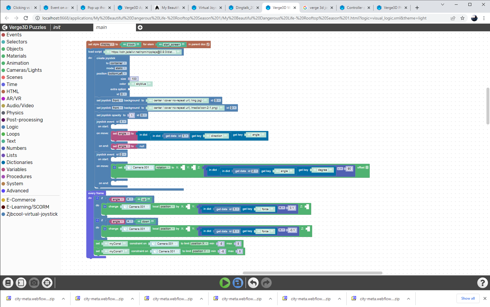

    jordangarlandmi
    Hello, I purchased the plug in. I am trying to move around my scene FPS style with the joystick. I cannot seem to get it to work. I attached my puzzle below. I am using the camera itself as the object being moved and rotated in the puzzle. I also have floor collision material on.
    I need to be able to still pan right or left when not touching the joystick also. Is this possible?
    Thank you for your time.
    #50242
    zjbcool
    Hi, You need to match the id of the joystick.
