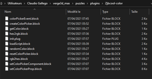

NaxosCGCustomerHello,
I’ve just bought the plugin, and put the Zjbcool-color folder into the
C:\Users\Claudio Gallego\verge3d_max\puzzles\plugins one.Restarted Verge3D
I con’t find puzzles (see screenshot) : what did i miss ?
2022-10-31 at 6:16 pm #56970kdv
ParticipantInside the
Zjbcool-color-v1.0you will find one more folder namedZjbcool-color. That’s the plugin folder.Puzzles and JS coding. Fast and expensive.
2022-10-31 at 6:46 pm #56971
NaxosCGCustomerI did copy the folder
2022-10-31 at 6:51 pm #56974kdv
ParticipantWhat is inside this folder? *.block files?
2022-10-31 at 6:52 pm #56975
NaxosCGCustomer2022-10-31 at 6:54 pm #56977kdv
ParticipantWell, then it should work. Maybe there’s a problem with permissions fo this folder…

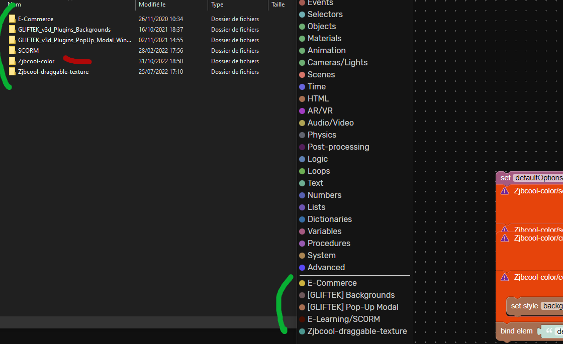

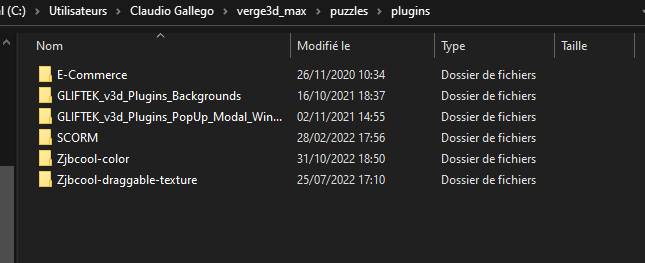

2022-10-31 at 6:56 pm #56978
NaxosCGCustomermmm, i can see other plugings i have, but not this one.
Strange.
2022-10-31 at 6:58 pm #56980
NaxosCGCustomerMaybe i should restart my PC…
2022-10-31 at 7:22 pm #56981
NaxosCGCustomerOk, got it :
since some Verge3D versions, the install folder is no longer
C:\Users\xxxx\verge3d_max\puzzles\plugins
but
C:\Program Files\Verge3D_for_3dsMax\puzzles\pluginsSo i was copying folder into the wrong old folder. My bad.

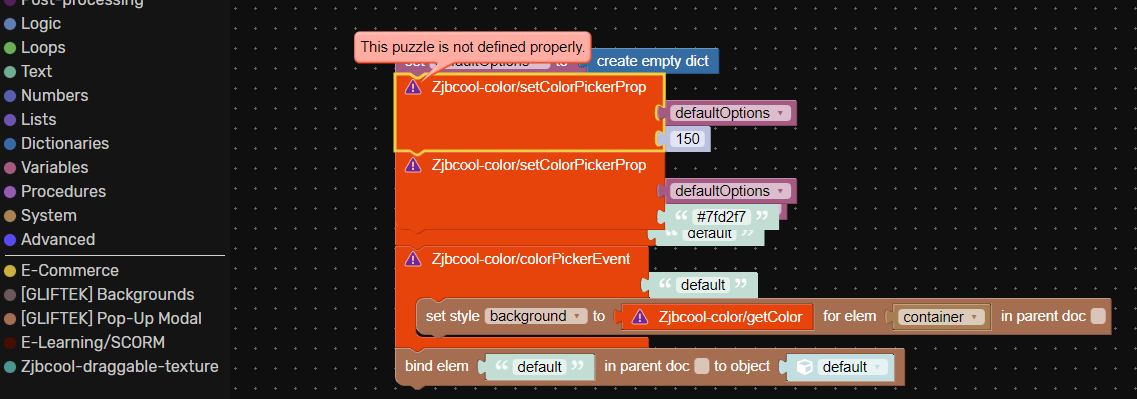

2022-10-31 at 7:41 pm #56983
NaxosCGCustomerSimple question though : how do i close the color picker ?
2022-10-31 at 7:47 pm #56985kdv
Participantset style
displaytononeor remove it…Puzzles and JS coding. Fast and expensive.
