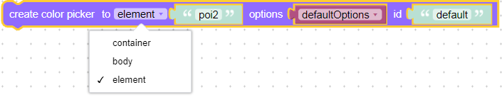

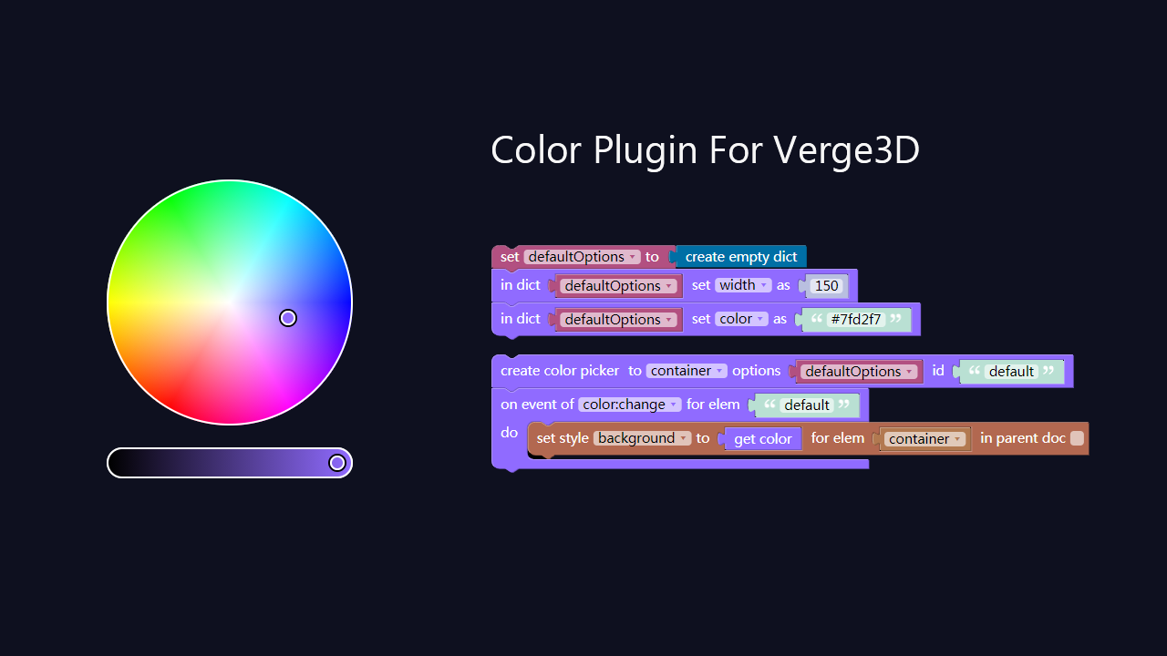

zjbcoolCustomerHi,
The Color plugin for Verge3D can create a color picker easily and quickly and with no need for HTML/CSS/JS or images, just a few puzzles.
Here is an example to show how to set up.
color-plugin-example

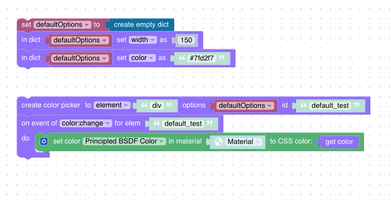

plz share Discord link & on your signature!2022-09-09 at 9:56 pm #55702raykjvdl
CustomerIs it possible to get a short tutorial. I’ve torn through this plugin and cannot find how you inserted Div id=default. I understand the concept but have not been able to get the picker to appear in my app.
2022-09-09 at 10:51 pm #55703kdv
ParticipantTry this

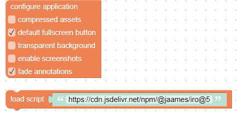

And don’t forget to add
load scriptpuzzle in the Init section
2022-09-10 at 12:27 pm #55728Raykjvdl
CustomerI see the problem I was having. I was not loading the script

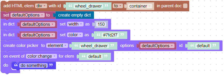

I also didn’t realize the puzzle created the html div automatically. I thought I had to create the div and assign it within the puzzle. Is there a way to do that using the “element” option? I would like to put the the picker into a html/css drawer that appears when its clicked or hovered. Right now the the div that is created has an inline style of “absolute” I would like to have it bare bones so I can style it and place it where I want within the html.
<body> <div id="v3d-container"> <div id="fullscreen_button" class="fullscreen-button fullscreen-open" title="Toggle fullscreen mode"></div> <div id="default_test" class="default-test">Color Picker here</div> </div> </body>The current setup I have isn’t working as I had hoped. See attachment.
Thanks in advance.

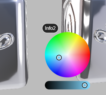

For example, here’s the color picker appended to an annotation.

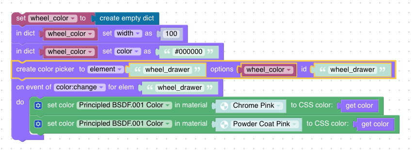

2022-09-10 at 7:14 pm #55735Raykjvdl
CustomerI’m wanting it to appear in a div of my choosing. i guess maybe im not understanding.
In this instance attached. I would think it would be inside of a div with the id “wheel_drawer” is this wrong?
2022-09-10 at 7:20 pm #55737kdv
Participantelement – “wheel_drawer” (it’s a parent element)
id = “default” (it’s a color picker element)The result: a color picker element with id “default” will be appended to an element with id “wheel_drawer” (if this id is present in HTML)

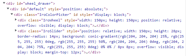

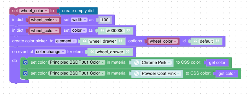

2022-09-11 at 12:05 pm #55742Raykjvdl
CustomerThanks for continuing to help. Still am not able to get it to appear. When I use the base puzzle that comes with the plugin I’m able to get it to work in my app. When I try to attach it to an element, I’m not able to get it to work. I set it up as you described above and nothing populates the div “wheel_drawer”
See attached images for puzzle and html.
2022-09-11 at 12:28 pm #55746kdv
Participanton event of color:changeis the event for a color picker with id “default”. “wheel_drawer” is just a parent node to which this color picker is attached. why do you listen to it to get color?On your screenshot the “wheel_drower” node is empty. What are the reasons to append the color picker to an empty node that shows nothing?
On my side I see no problems. The attached color picker node follows its parent position and visibility…

2022-09-12 at 12:10 am #55751kdv

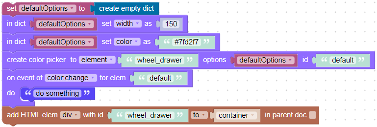

ParticipantAnd still I see no problem on my side. Just created
<div>and attached the color picker to it.
I’m not wanting to attach the color picker to a node
<div>is a node.In the screen shot of the code, it is empty because I cant figure out how to get it to populate in that spot.
Looks like you first create a color picker, trying to attach it to an unexisting
<div>node “wheel_drawer”, than later in the code you create this node and as a result it’s empty )))This variant is not working. You can’t append a childe node to an unexisting parent.
