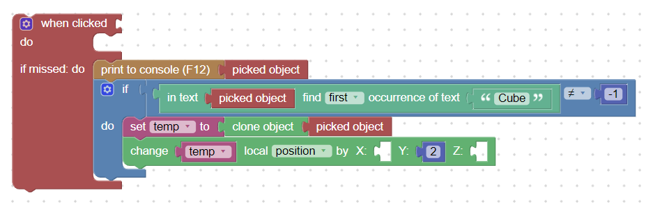

CustomerHi,
There seems to be an change with 3.5 that is affecting an approach I have used for ‘When Clicked’ events and cloned objects. I have been creating a When Clicked event with no object, then using the ‘if missed do…’ to return the Picked Object name, then decide what to do based on the name.
I have attached an example puzzle using the standard Cube template. This seemed to be an efficient approach compared to creating an event for every object I clone. In my project, I need to clone a lot of objects (think of Legos).
It seems with 3.5, the picked object name is coming back null. It seemed to work after updating the project, then stopped after I saved it. Seems to be replicable with the simple puzzle attached. It works at first, then stops returning the name with the Picked Object.
Perhaps this is not a good approach? Maybe it is a small bug in 3.5?

Yuri KovelenovStaffHi,
since you are using when clicked without a target object, then picked object should always return null. It still can be not null if you’re using another when clicked puzzle somewhere else. The reason is that picked object is a global variable, so depending on previous events happened in your app it may be null or not null.

Yuri, I know this is an odd approach, but in 3.4 and prior, the picked object always returned the mesh name. I put an example of 3.4 with this puzzle attached. Check out the console output. I was careful to name the original mesh Cube.0 so the clone name would be predictable (Cube.1, Cube.2, etc.). Here’s the 3.4 example: https://cdn.soft8soft.com/AROAJSY2GOEHMOFUVPIOE:091950d814/applications/CloneTest/CloneTest.html
Here’s the exact same in 3.5: https://cdn.soft8soft.com/AROAJSY2GOEHMOFUVPIOE:ff74dcf89a/applications/CloneTest35/CloneTest.htmlJust updating the project after upgrade to 3.5 does not affect the behavior, but changing a puzzle and saving does.
Again, if this is a terrible approach, I am open to other ideas to be able to capture click events of cloned objects. Here’s my production project that involves a lot of cloning: https://cdn.soft8soft.com/AROAJSY2GOEHMOFUVPIOE:ff74dcf89a/applications/ShoreStationDock/index.html
Perhaps a custom routine? I’m not a great coder, so I’d need help:)
Thanks,

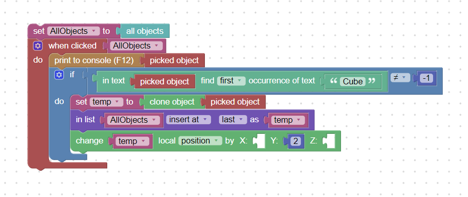

I gave this a try. I created a list called ‘AllObjects’ and added all mesh objects to it. I have attached the puzzle where I add any new cloned objects to the ‘AllObjects’ list. It seems the When Clicked event does not see the change to the list. It looks like the event only pays attention to the contents of the list when it is initiated – correct?
Thanks,
JonAttachments:

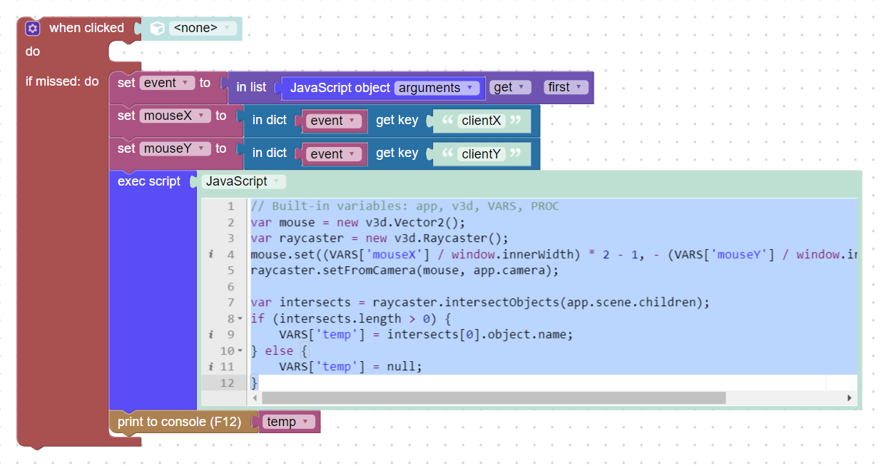

CustomerOK, so I did find a workaround: The attached puzzle worked (not in the preview window though). The code in the ‘Exec Script’ puzzle is:
// Built-in variables: app, v3d, VARS, PROC
var mouse = new v3d.Vector2();
var raycaster = new v3d.Raycaster();
mouse.set((VARS[‘mouseX’] / window.innerWidth) * 2 – 1, – (VARS[‘mouseY’] / window.innerHeight) * 2 + 1);
raycaster.setFromCamera(mouse, app.camera);var intersects = raycaster.intersectObjects(app.scene.children);
if (intersects.length > 0) {
VARS[‘temp’] = intersects[0].object.name;
} else {
VARS[‘temp’] = null;
}This returns the name of the mesh if hit, or null if not.

Yuri KovelenovStaffIt seems the When Clicked event does not see the change to the list. It looks like the event only pays attention to the contents of the list when it is initiated – correct?
Yep, the event listener is only applied to the original contents.

2020-12-21 at 11:29 pm #36789jdock
CustomerYuri,
I have having difficulty getting the ‘code puzzle’ to work with the 3D embedded. I have the 3D window in an iframe with an id = 3dFrame. I seem to be getting the correct mouse coordinates, but the raycaster doesn’t seem to intersect anything. Any ideas?
Here’s my attempt to refer to the embedded window height and width:
`// Built-in variables: app, v3d, VARS, PROC
var x = document.getElementsByName(‘3dFrame’);
mouse.set((VARS[‘mouseX’] / x.innerWidth) * 2 – 1, – (VARS[‘mouseY’] / x.innerHeight) * 2 + 1);
} else {
}Jon
