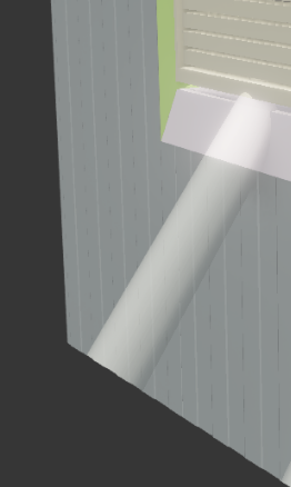

    Dear Verge community,
    I used clipping plane to create “rising pipe” animation. The hidden part looks ghosted on Verge 3d. Please check attached screengrab. How I can fix it? Would appreciate any advice

    сcan you share the project files?

    @Mikhail, thank you so much for response.
    I figured it out : I applied the environment from Machinery Material Pack – removing this environment solved the issue.

    to use rising pipe you can also try vertex group & shape key animation option..
    just a possibility
