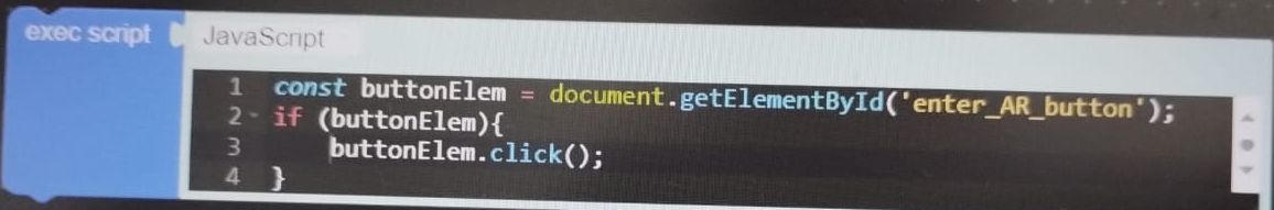

    Once the webpage has finished loading, is it possible to enter AR mode without the user needing to click the “Enter AR” button? Can we simulate the button click so that the user does not have to manually press the button?
    I attempted to use the following puzzle (see image) to simulate the button click, placing it before the “Check AR Mode” puzzle. However, I am unsure how to handle the simulated button event within the puzzle.
    Could you please provide me with a solution.
    #74877
    You can simulate clicking but you can’t enter AR this way. Not allowed without a user interaction.
