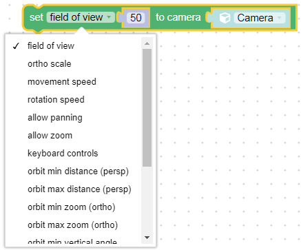

    When exporting, the ranges for the camera movement and its rotation H and V limits, are parametric values that can be set.
    When zooming in, lets say from a cube to one of corners, the camera may cross the cube while rotating from its new closer position.
    Is there a way to access those values from the puzzles (camera range, camera V and H rotation limits)?
    If not, what could be a walk-around for limiting the camera ranges?

    Thanks, I found it after posting… :good:
