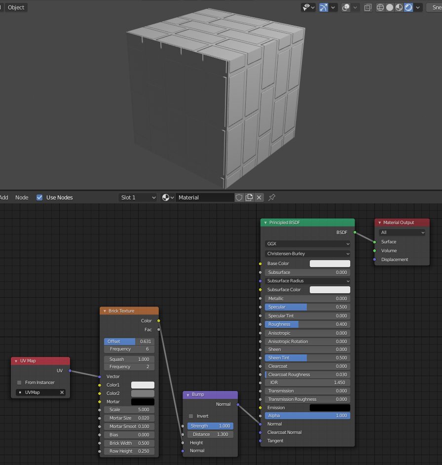

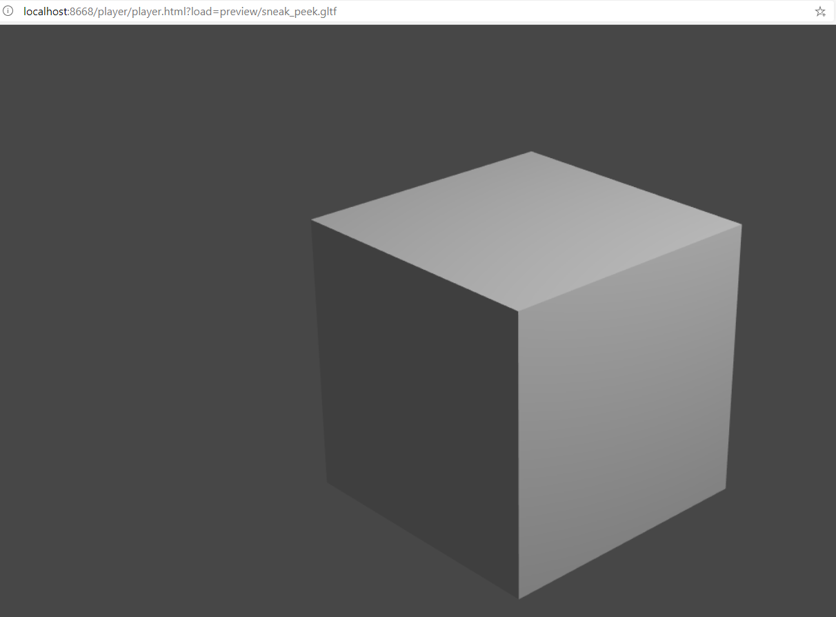

    I have read that Bump node support was added for Blender a while back, however it doesn’t seem to be working for me. Is this a bug or am I doing something wrong? Normal Map node seems to work fine, but I need to use the Bump Node for my application.
    See the attached images showing the default cube with a brick texture bump node and the result in blender. And the image of what it looks like in the browser. I updated from Verge 3.3 to 3.5 today and got the same result.
    Thanks!
    #35916
    Bump node supported, but not a brick texture.
    #35969
    Adding Brick texture support to our TODO list.

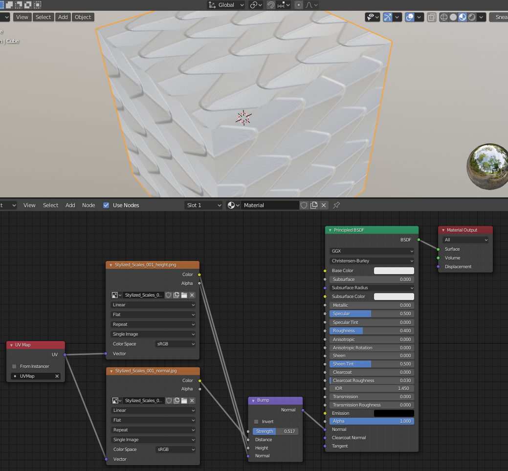

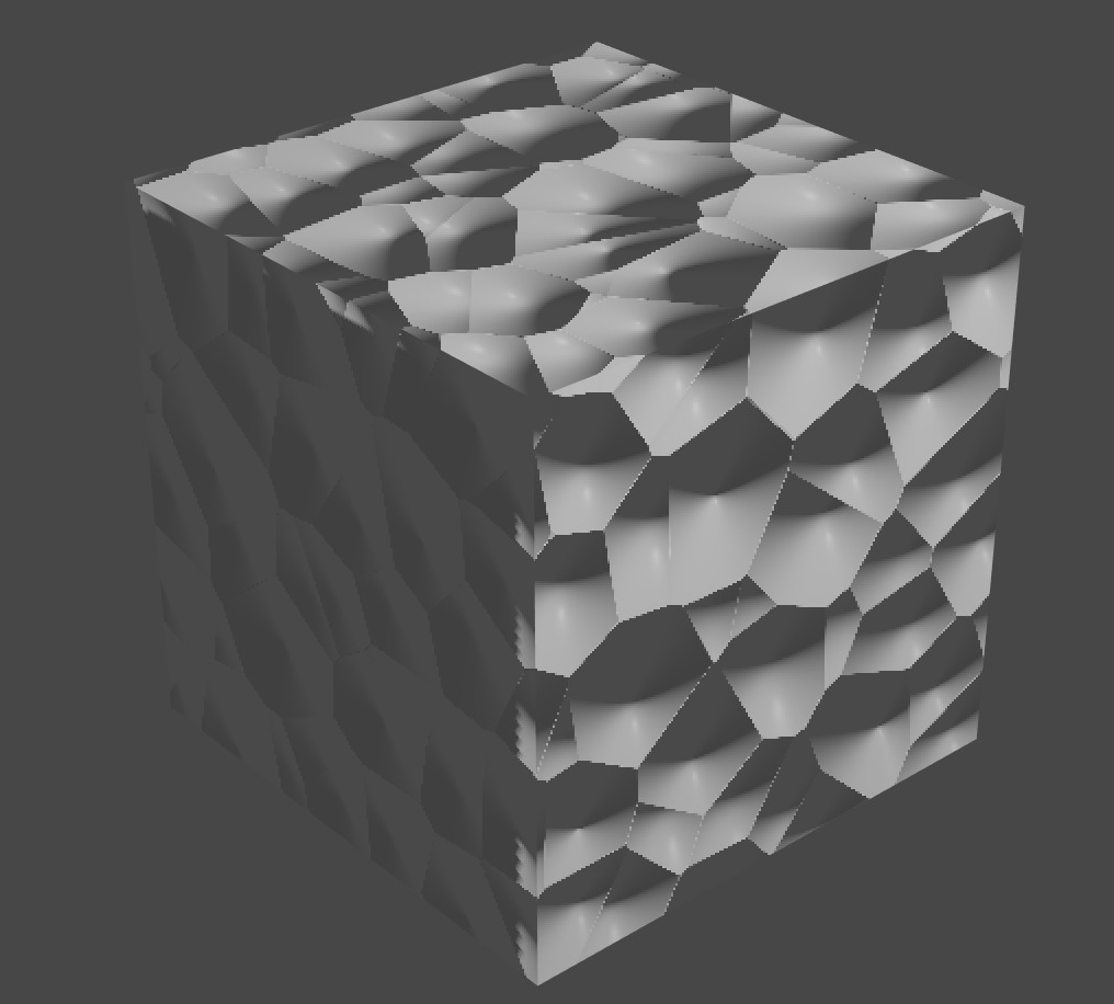

    I don’t this is specific to only the brick texture. Here is an example using an image texture with the same result: the effect in Blender is not transferred to the Verge3D scene.
    #36062
    It’s work for me well. Can you share your example?
    #47159
    Hi.
    The Brick texture will be supported in the next release, hope it will be helpful!
