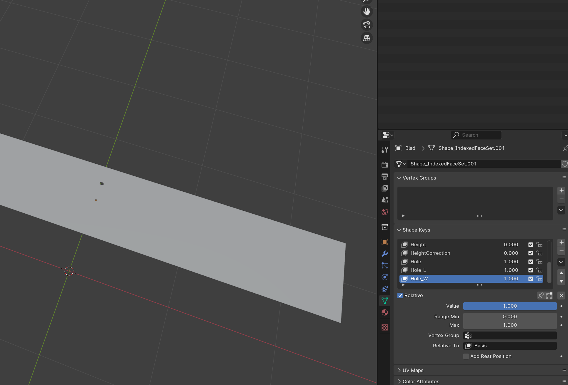

    I have a problem where shapekeys (of a hole) work fine in Blender (4.1.1) but when I export the file to Verge (4.7.1) the shapekeys related the the hole aren’t visable in the verge viewer. Attached is a stripped down version of the project with only the part in question and a screenshot in the shapekeys in action in Blender.
    (the goal is to create a hole in the plate that can be positioned with the shapekeys)
    What am I doing wrong?
    Thanks in advance, Marten

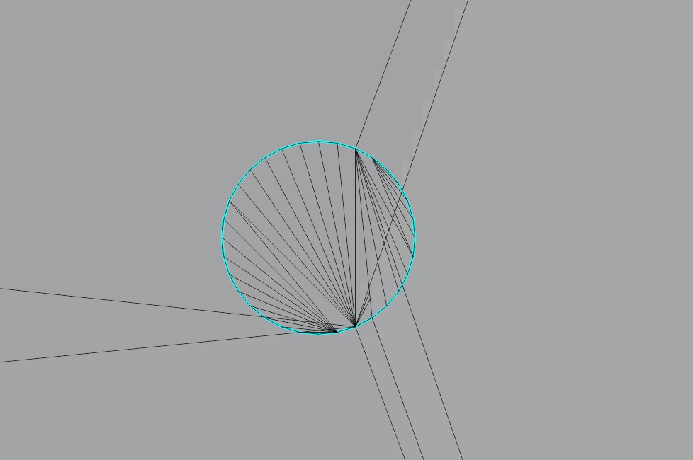

    It’s because you use ngon, but when you export to the engine thw whole mesh triangulated and you get this.
    So you need to triangulate the model manually and remake shapekeys again after triangulation.
