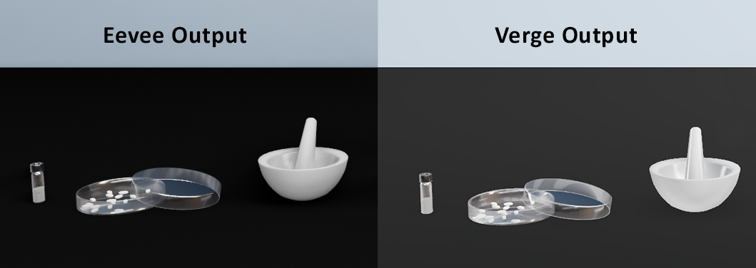

gajanan5CustomerHi,
I am facing one issue in lighting & look while exporting the scene
from Blender to Verge 3.6
Lighting is not matching with the blender output. Everything is overexposed/washed out.
Attached image for visual.
need your help to achieve Eevee output in Verge space.Thanks & Regards

Mikhail LuzyaninStaffMay be you enabled some EEVEE postrocessing effects like AO, SSR or Contact shadows? If no then can you try to test your scene in different browsers?

gajanan5CustomerIn this setup, I have used a spotlight & HDRI. Spotlight creating a shadow.
2021-05-06 at 7:19 am #40758
Mikhail LuzyaninStaffThere’s a lot of things enabled that are not supported: contact shadows, IR-map, AO and Screen Space reflection. You also checked GLTF2 compatible checkbox on some materials, so they will work in compat mode and will not look as EEVEE materials. You need to disable all this checkbox to get the similarity between EEVEE and VErge3D.

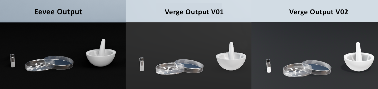

gajanan5Customerattached updated output ..
2021-05-06 at 4:12 pm #40815
Mikhail LuzyaninStaffI forgot to say about exposition, it’s not supported too. You need to return it to default value.
