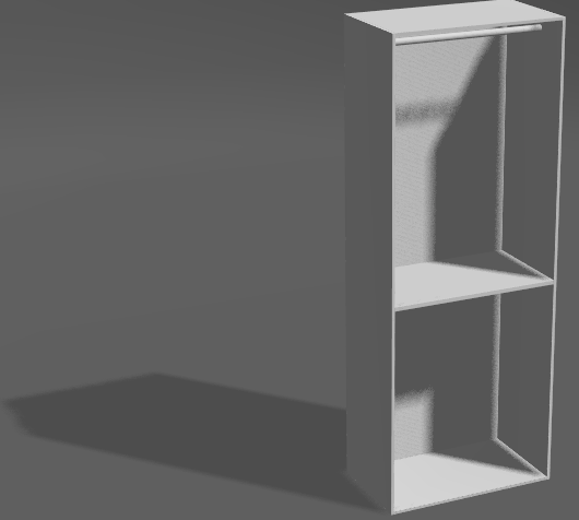

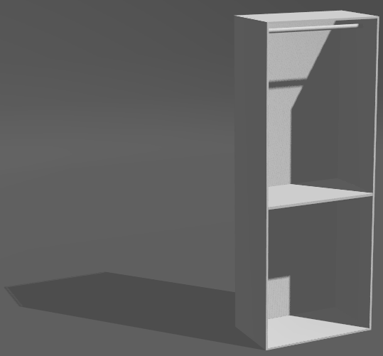

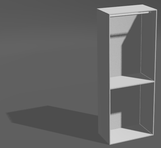

    Hello. I have a problem with shadows. The object is simple and a strange light shines through… what am I doing wrong??

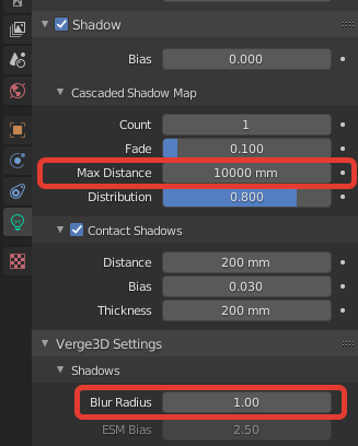

    This issue depends on the derectional light shadow map resolution. Those white spots are the result of edge blurring.
    These options affect the sun’s shadows quality
    #60863
    kuglaz
    Thanks a lot…it works!!! I spent a lot of time looking for a solution!
