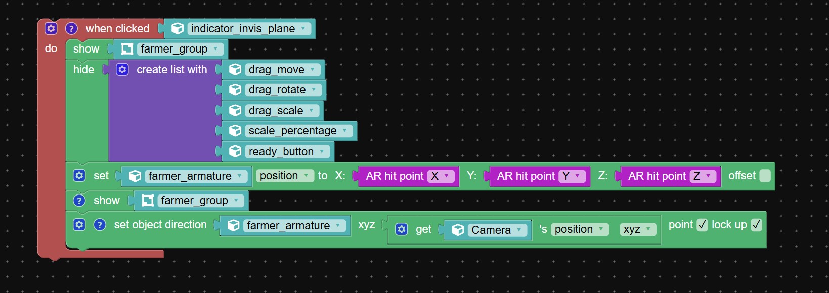

In the farmer model when you activate ar it opens an option for edit location and size, i can’t find anything in the puzzle logic about can anyone advice?2024-06-18 at 1:17 pm #74935
visualizerParticipantHere is a set of puzzles about the location (position) of that cartoon boy.
however I think it carries a same model scale as blenderAttachments:
