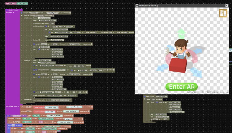

    I’ve been trying to learn verge3d for 2 months, I figured out most of the things, but I couldn’t figure out how to work with AR, so I had to register and create this form. Is there anyone who can support me?
    I downloaded the sample AR application (attached). I can add any code I want into AR by changing the source code, but I cannot run more than one object in AR and move them separately. Puzzle construction is attached. Can you tell me where I made a mistake? If the box comes, the character does not come, if the character comes, the box does not come.

    To provide help it would be helpful to know what devices you are wanting your application to run on? Android, iPhone, other?
    Can you post the code you are using to move a leg? Or code you have tried?
    The process for AR is very similar to a standard web implantation if you are using Android or XRviewer on iOS. If exporting to USDZ that’s a different issue.
    When you export a model the individual meshes will be separate unless you have told your 3D app to join them first or if you have the verge 3D plug-in settings to optimize the meshes.

    https://we.tl/t-ti17eRisve all the files of my project are here. I have already cloned the project on the threshold. In the 3dmax file, I just drew a box next to the character and added it to the puzzle, but even though there are 2 objects in my 3Dmax scene, only one object appears in AR. I tried it on iOS and Samsung tablet, one object works on the phone, but when I try to add two objects it doesn’t work. I did the standard method in the project and didn’t do anything extra. Any chance of creating a structure in AR where I can display more than 2 objects in the puzzle and adjust their positions individually? I can’t buy a license because I can’t do this:(

    I am testing with ios safari. It doesn’t open AR on Android phones; on a Samsung device (I scan the QR code), it shows a single object, but when I ask it to show two objects, it doesn’t enter AR mode. I haven’t installed any application or anything else on the tablets or phone.

    and be able to move them to separate positions
    it’s not possible for the iOS AR mode (Safari + Quick Look) in Verge3D apps.
