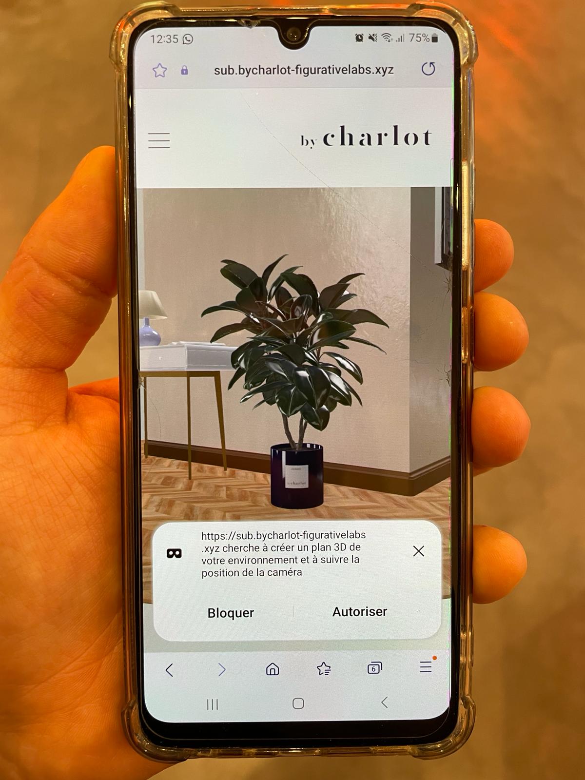

    I took the time to check on different Android Phones with AR core downloaded and I still have the same issue. All the phone I have tried are able to do AR but it doesn’t work for verge3d AR.
    When I activate from my app, it asks me the authorization to make a 3D scan of my environment + position of my camera but then nothing happen. I try to click again and nothing happen
    I have even tried with verge3D augmented reality demo with the farmer and I have the same issue !
    With Iphone no issue at all..
    Any suggestion ?

    Are you using Samsung Internet browser by any chance? It appears to have some issues with WebXR content. Can you try if it works in Google Chrome browser?

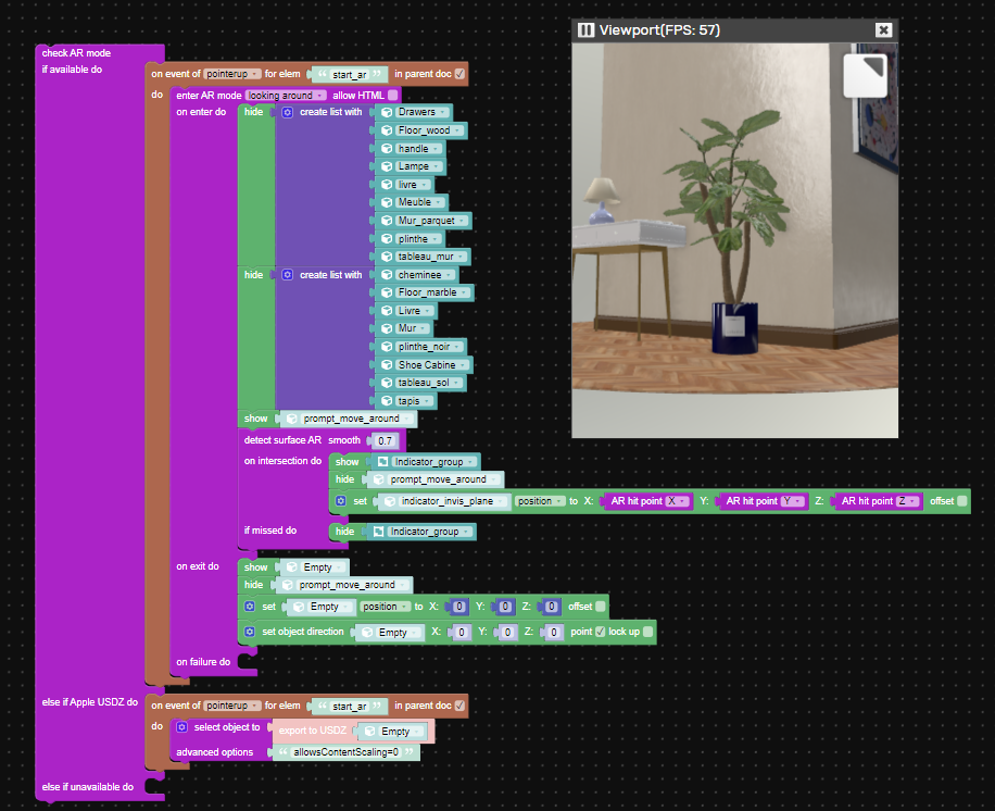

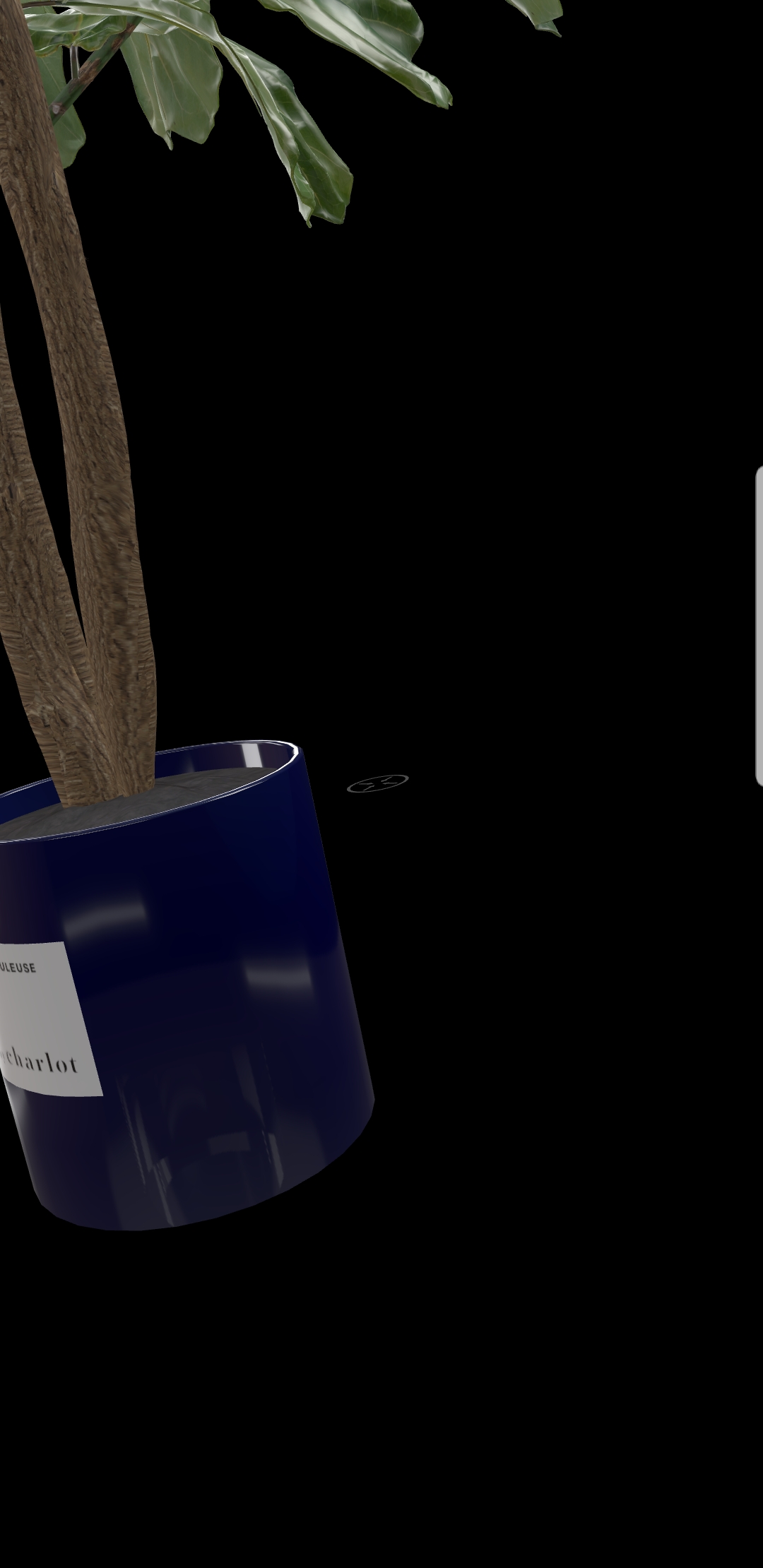

    Since the AR functionality is working, I have noticed that am still far from the Farmer demo result.. The background is black and it doesn’t even try to scan the ground.
    I have tried to follow each step, have I missed something ?

    You didn’t enable the transparent backgroud option on the Init tab.

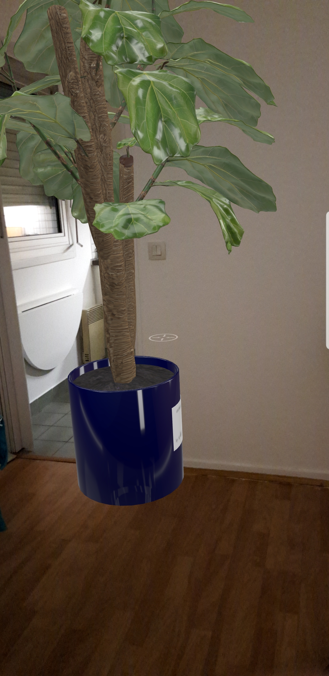

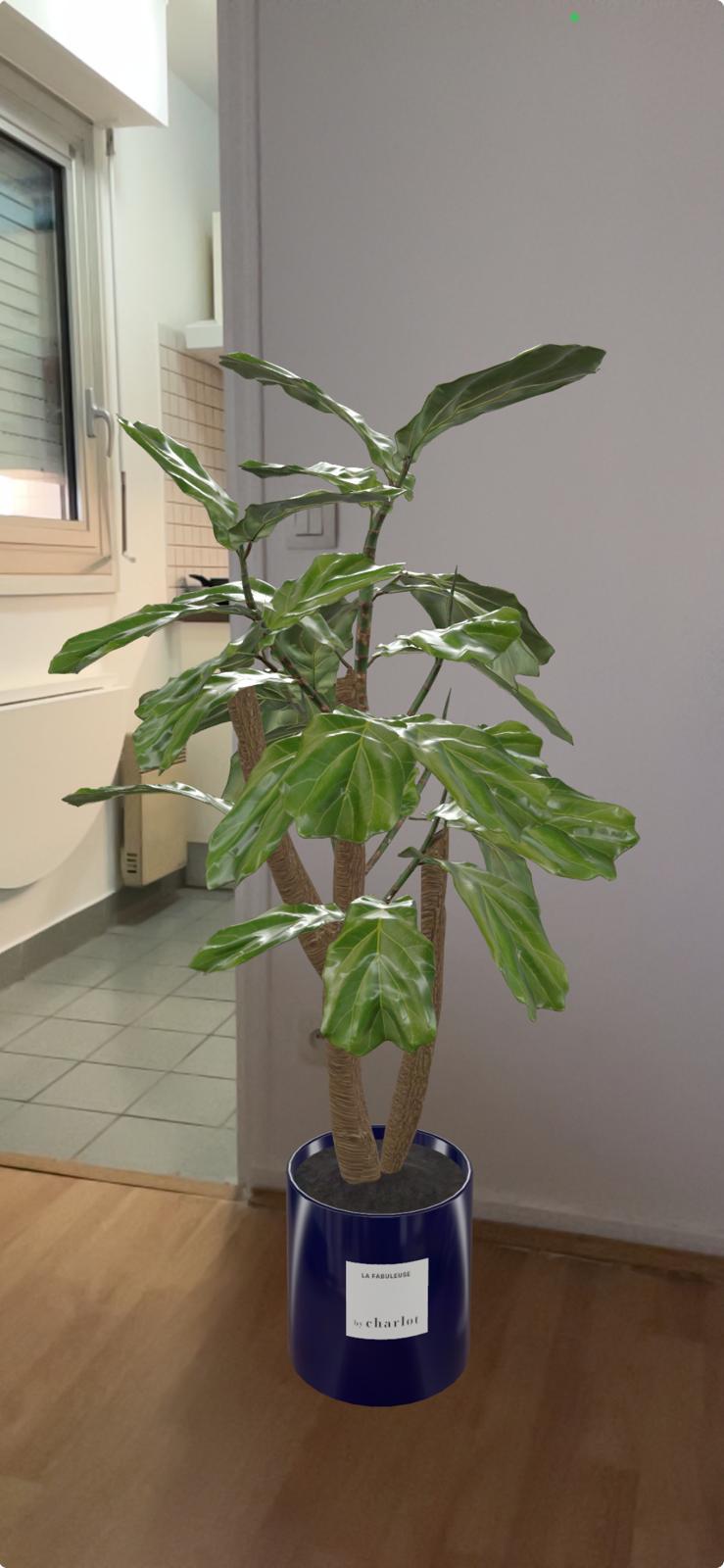

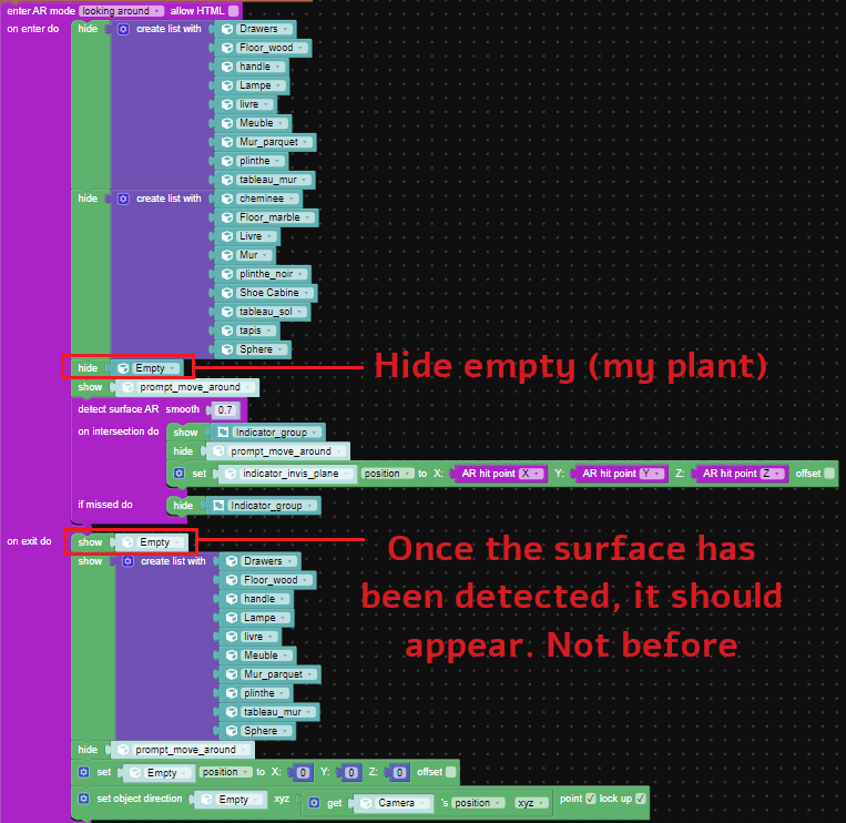

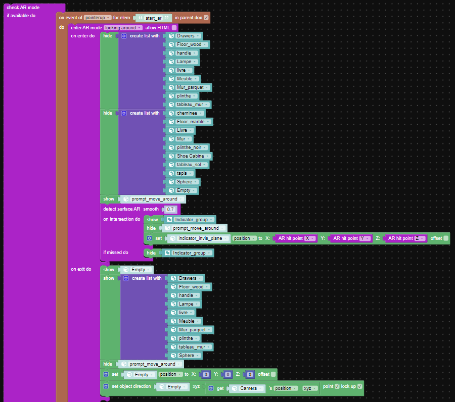

    Now, I am getting very close to get it down.. One last thing that hold me back, may I ask you why my “Plant” (which is an empty of several object) appear where my phone is ? It appears instantly (floating in the air) and not on the target when I click on it.
    Thank you
    #70334
    Most likely the origin of your plant (or the origin on its parent object) is not at the bottom of the pot.
    #70335
    jojopellerin

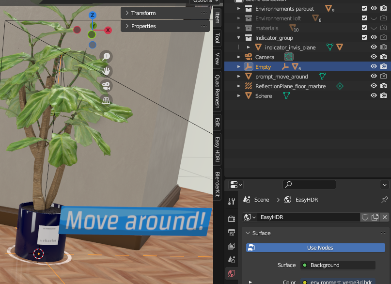

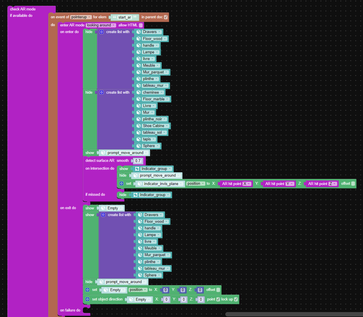

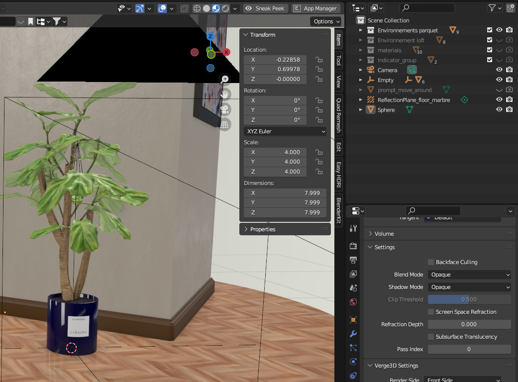

    I checked that. The origin is good (see my blender viewport SC). Also, when it exports my USDZ, it is centered.
    The issue here, is that the plant appears instantly (right after the camera turn into AR mode) at the location of the phone itself. While the plant remains floating in the air at the same spot, I can start to swipe the floor and then my “indicator_invis_plane” appears as it should be.
    Also, even if I click on the “indicator_invis_plane”, the plant stay at the same location. Basically nothing happen.
    #70340
    Nothing to say more without the app itself. You did some mistake (maybe in puzzles, maybe in Blender) and without files it’s difficult to figure out what’s wrong. And it’s not a good idea to discuss AR for Android in the topic about AR for iOS…
