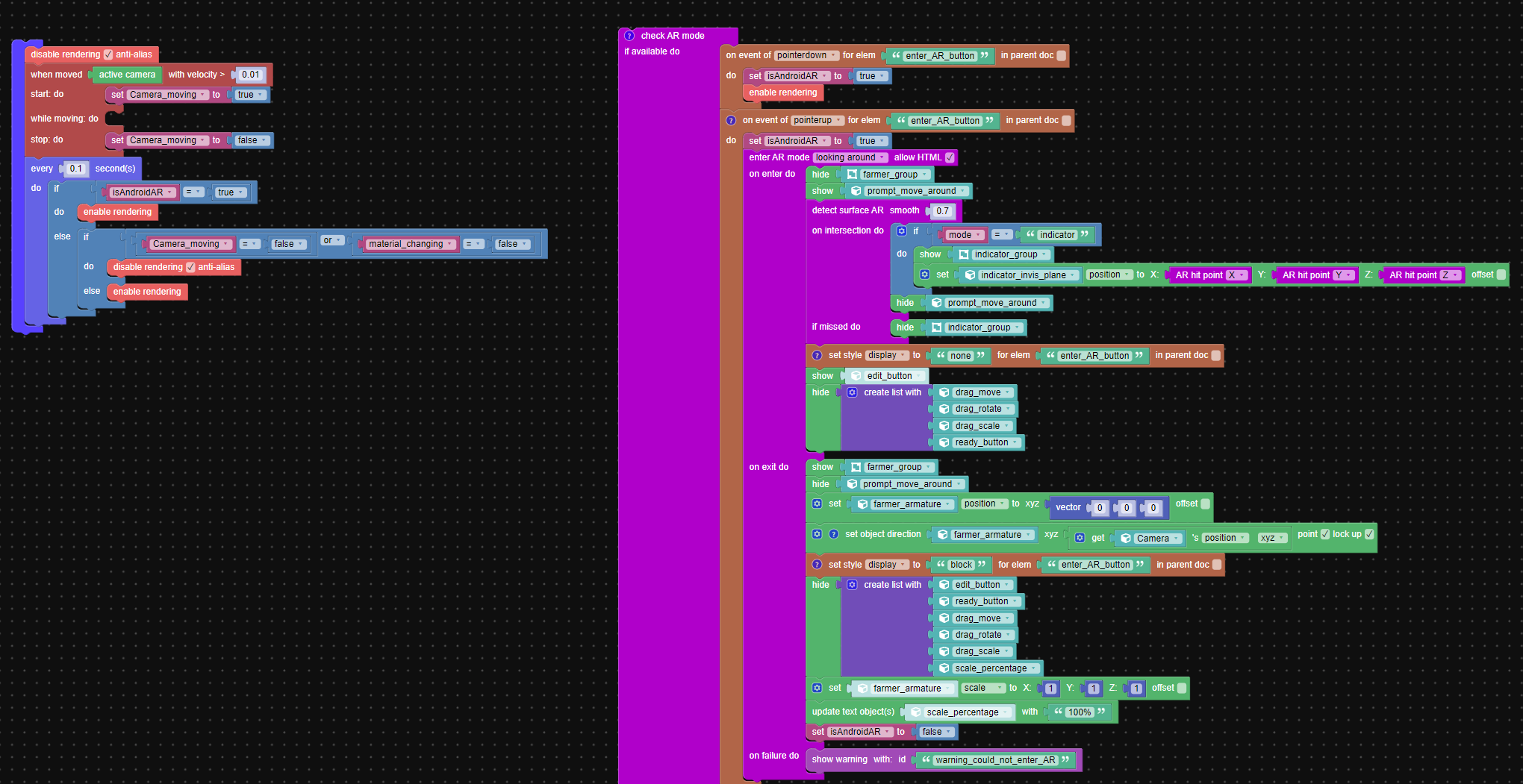

NaxosCGCustomerHint: rendering is disabled when you enter the AR mode (according to your puzzles). And it’s not working. But if you enter the AR mode when rendering is not disabled it’s workin fine. Think.
I’ve also tried to put the “rendering enable” puzzle at the very top of the
If available / on event pointerup for elem “enter_AR_button”
same issue…Maybe i should before a “on event on mouse down on elem “enter_AR_button” to set “enable rendering” ?
I’ll give a try."1+1=3... for large values of 1"
2024-04-25 at 9:03 pm #72520kdv
Participantit’s not enough (but necessary) just to enable rendering before entering the AR mode, it’s also important to prevent rendering from being disabled by your puzzles.

NaxosCGCustomerNot working
v3d.net/ahtsee attached : i’ve put enable rendering as soon as i come into AR…
2024-04-25 at 9:07 pm #72523kdv
Participantyou did wrong using the second event listener. you need to enable rendering and prevent it from being disabled.

NaxosCGCustomerHere is the full app : https://we.tl/t-FuZwmoVK9B
Not working.
As you can see, setting the variable and rendering enable is first things done entering the AR, clicking the enterAR button.
With the test : https://v3d.net/aht you may see that moving the camera then stop freezes the animation : disable rendering + AA
As soon as we click the EnterAR button, animation is back before going to smarphone’s real camera for AR, so enable rendering is triggered.But, no “move around” is shown, and so no AR is working.

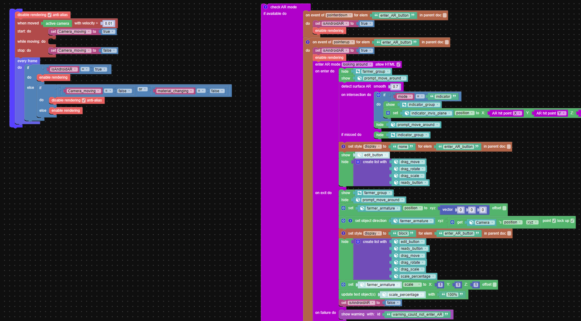

NaxosCGCustomeryou did wrong using the second event listener. you need to enable rendering and prevent it from being disabled.
It shoud be prevented, as the variable isAndroidAR is set to “true”.
And if is true, then the “disable rendering + AA” should not be triggered, as my every 0.1 seconds is set.
(tried every 0.1s instead of everyframe event)"1+1=3... for large values of 1"

NaxosCGCustomerModified it :
back to every frame, and doubled the enable rendering / set variable.
Not better.Attachments:
2024-04-25 at 9:40 pm #72529kdv
ParticipantThe problem is deeper than just disabled rendering (activating SSAA causes the issue) and this is up to guys from S8S to figure out what’s wrong in v3d.js and how to bypass it when entering the AR mode.

2024-04-26 at 10:39 am #72534kdv
ParticipantBTW, there is no issue if the SSAA pass is working permanently. The pass itself is not a culprit. The problem is somewhere in the enable/disable rendering logic.

NaxosCGCustomerHi Claudio,
We are going to fix this issue for the upcoming Verge3D preview (finally!).Great news !!
