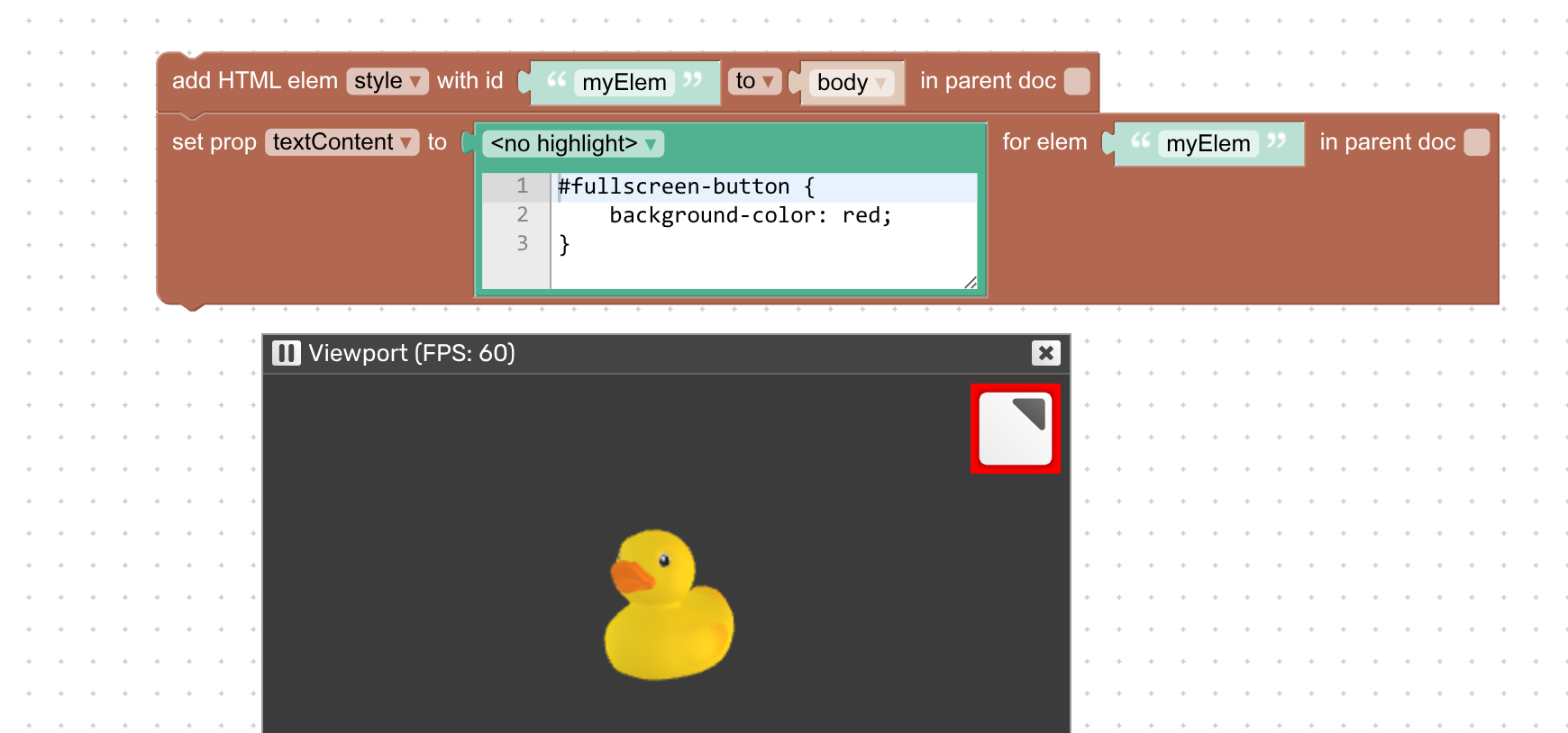

    You CSS code can not be executed this way (using the exec script puzzle). To apply your custom CSS logic create a new <style> element and put your CSS code as “textContent”:

    1/ I don’t understand how to use puzzles to reference this behavior only for the object when hovering over it?
    The only thing I found was to add an exec script that completely describes the behavior without puzzles.
    2/ Is there a way to reference the annotation icon itself?
    The biggest problem right now is that when you scale the annotation on hover, the annotation dialog also scales.

    #84913
    It’s a bit tricky, but you can create custom CSS animation that changes width/height/offset etc. of the “.v3d-annotation” class. This way the child dialog element won’t be affected.
