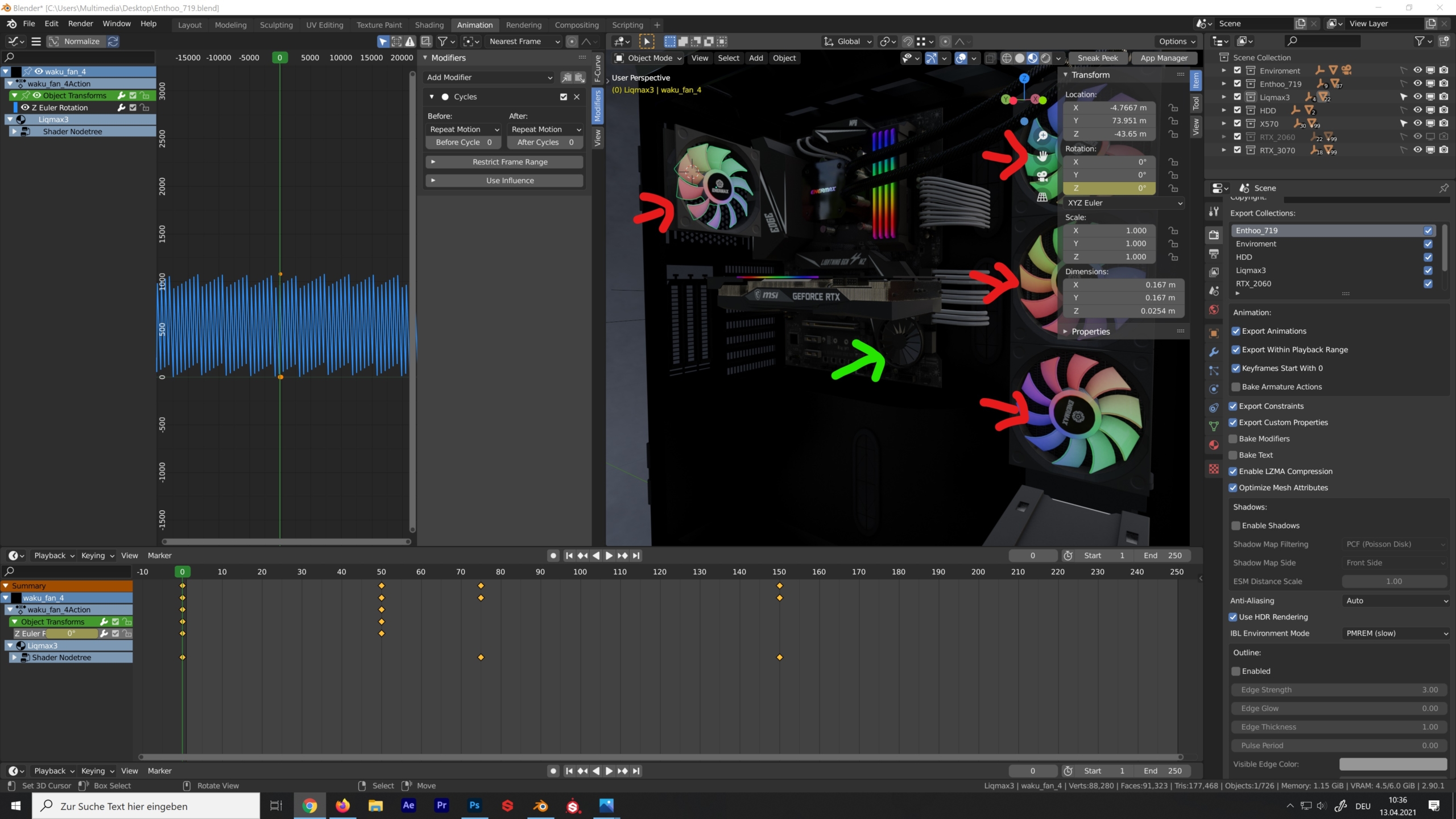

    Maybe someone can help me out, I have a small issue with exporting the animation from blender.
    I have a pc model with all the components, and i have to animate the fans with an endless cycle loop.
    In blender it works like it should, but when i open the puzzels, the fans are stoping and starting again.
    I attached an image with all the settings and i marked with red arrows the fans that are always stoping, and the green arrow marks the fan that is working without any problems.
    What could be the issue, somebody else run into this problem?
    Thanks in advance for help!
    #40299
    Animation modifiers not supported, if you want to circle a piece of animation you need to copy all keyframes manually as much as you needed.
