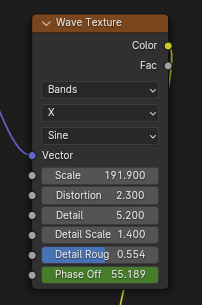

    Hi, is it possible to animate shader values in Verge3D as per the green “phase offset” in the wave noise node …

    Yes, you can animate that.
    There’s a reference page that shows you what you can animate on each texture node.
    https://www.soft8soft.com/docs/manual/en/blender/Shader-Nodes-Reference.html
    A green checkmark means it can be animated, and a red “x” means that it cannot be animated. If you go down to the entry for the Wave Texture everything can be animated except Detail Roughness, right above the Phase Offset.
    Connect Value to the required input and animate it.

    #68591
    PLAN8
    This was this bit that I was missing, as the value in the texture node wasn’t being animated – thanks for this somewhat obscure tip! :good:
