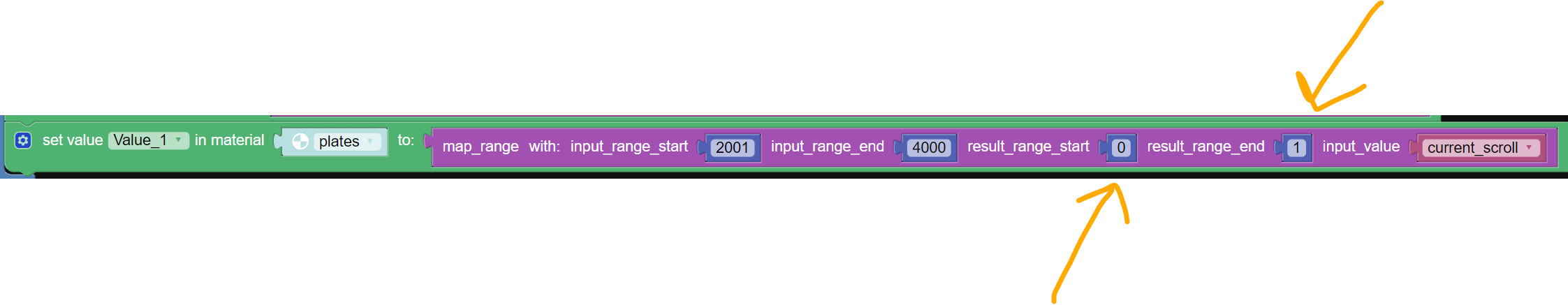

    Hi, I’m animating a mix shader to fade between two colors. The animation plays fine in blender, but it won’t play in verge3d. Any thoughts?
    #11227
    Animating the Mix shader directly is not supported by Verge3D. Animating a Value node connected to the Mix shader should help.
    Founder & CEO at Soft8Soft
    #11240
    nm2kid
    Awesome. Works perfectly. Thanks for the quick reply.
    #11252
    glad it helped! :good:
