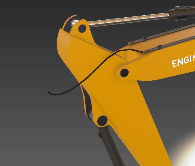

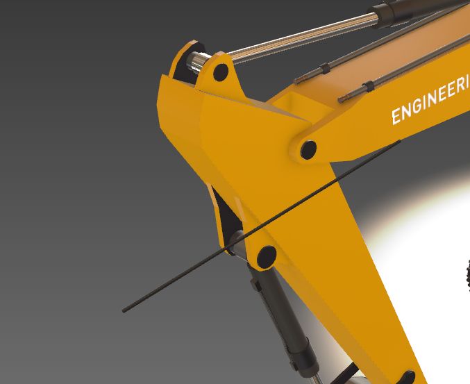

jefferywright2194ParticipantHydraulic hose connected to a cylinder animation: I have a curve composed of 2 nodes and one of its nodes is connected to a hook which is attached to an object that moves.
It works fine in the editor but in the Verge3D canvas the hook is ignored.
Is this possible to achieve? Am I missing something?
Thanks.

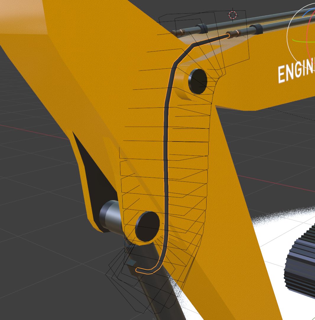

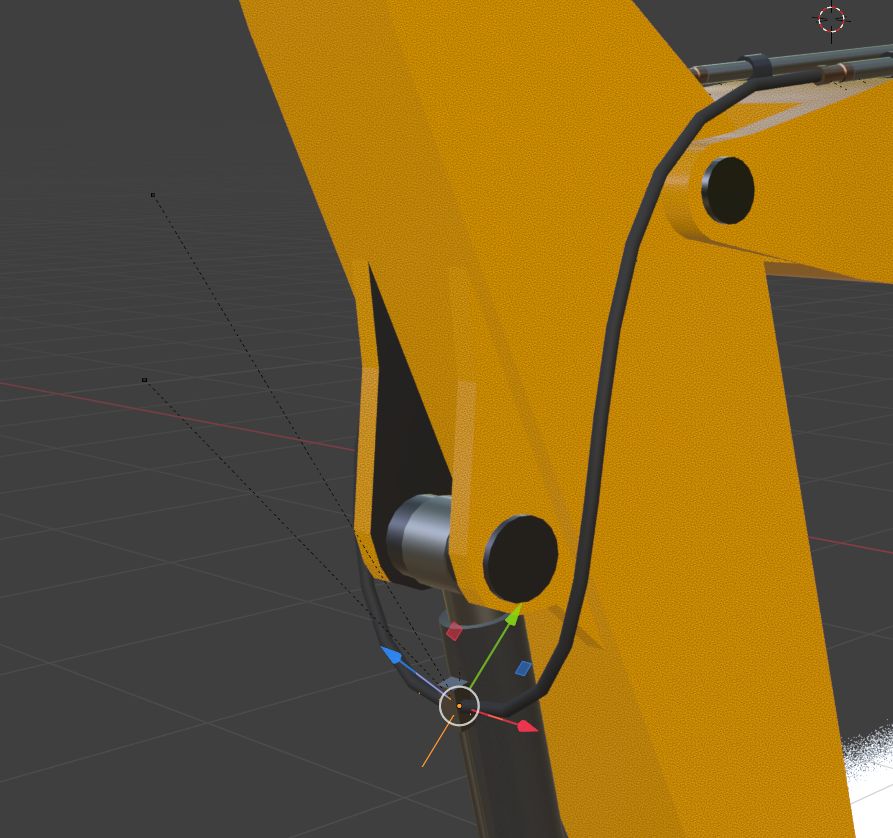

jefferywright2194ParticipantThanks,
I’ve tried shapekeys, which is a mess to try and loop, Armature is also ignored on publish…
2025-08-07 at 5:56 pm #83545
jefferywright2194ParticipantBendy Bones is entirely ignored.

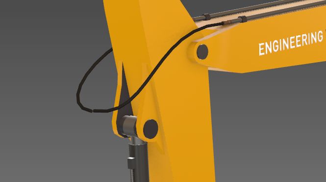

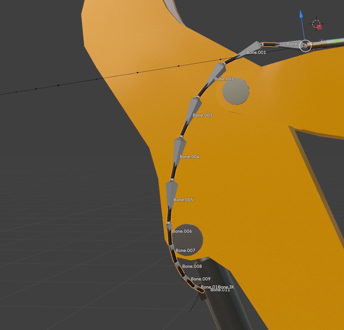

jefferywright2194ParticipantThanks for that info, I will check those links out.
Blender 4.5
Verge3D 4.1I think I have it sorted, using bones is a real chore and the results are iffy… stiff and segmented.
But at least it works now, I appreciate your help, I’ll try a few more things to get the smooth hose effect I’m looking for.
2025-08-08 at 2:35 pm #83555
xeonCustomerThe smoothness of the bend is dependent on the segments of your tube / cable. My rigs for these things typically consist of 32 or more bones. I typically address the bones as an object and use logic to rotate the armatures as needed based on other driving variables. In your case as the robot looking arm moves…then there would be logic that rotated each bone to account for the angle of the robot arm. Bendy bones work too but…the overall effect is no different than a standard armature once inside V3D. However if you robot arm is well defined and constrained then shape keys are the simple solution.
