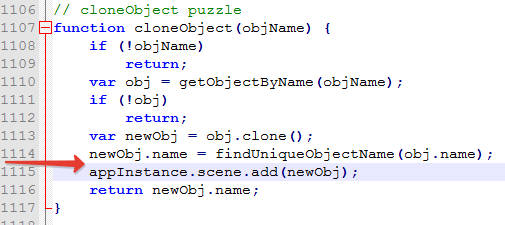

kdv Solution seems to work nicely but I don’t understand how and where to implement this. Is it possible to share how you did this?2023-06-06 at 9:43 pm #64414kdv
Participantbut I don’t understand how and where to implement this
That code above should be used inside the
cloneObject()function that can be found inpuzzles.min.jsOr you can use this plugin which includes the modified puzzle.

ParticipantIf you open
visual_logic.jsyou can find this function (initially it’s inpuzzles.min.js)
In that function you can add this JS code to clone an object’s animation.
const objAnim = v3d.SceneUtils.getAnimationActionByName(app, objName); if (objAnim) { const newAnim = app.mixer.clipAction(objAnim._clip.clone(), newObj, objAnim.blendMode); newAnim._clip.name = newObj.name; newAnim._localRoot = objAnim._localRoot; app.actions.push(newAnim); }Once it works you can transfer this code into
puzzles.min.jsif needed.Puzzles and JS coding. Fast and expensive.

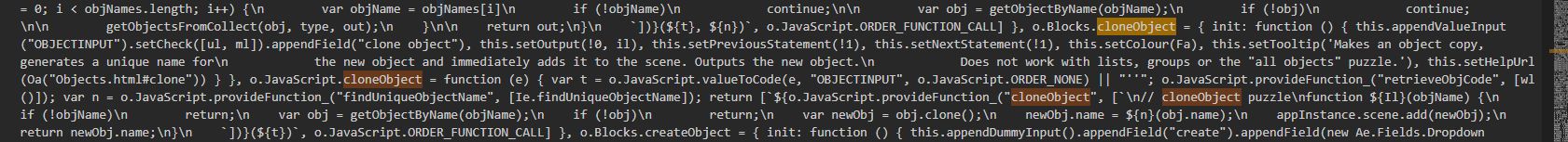

ParticipantHi,
I have opened the puzzle.min.js file to search for the cloneObject function, but it is appearing in a different format, which you can see in the image attached here.Do I need to download some specific software or application to view it in the format that are visible in your solutions above?
2023-07-22 at 2:05 pm #65371kdv
ParticipantYou see the same function but as a single line. EOL is replaced by
\nPuzzles and JS coding. Fast and expensive.
