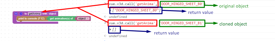

Problem Scenario
I have some doors in my scene which consist of some objects (frame, trail, sheets…) with the frame as their parent.The door sheets have been animated using keyframes in blender (position and rotation).
These doors get cloned several times, to fit all floors.
I am using puzzles to play the animations, but it is not working as expected.
The puzzles play only the animations on the original objects. I tried to debug it and I found something interesting:
Verge tries to find the animation by objects name (getAnimationActionByName()), comparing the name of the object to all items inside an array (e.actions).
Inside this array I could only find the animations of the original objects and nothing from the cloned ones.So, I suppose this is the reason it does not animate the cloned objects.
Now I am looking for a way to fix this problem. I need to animate every door individually. Is there a way to clone the animations as well?

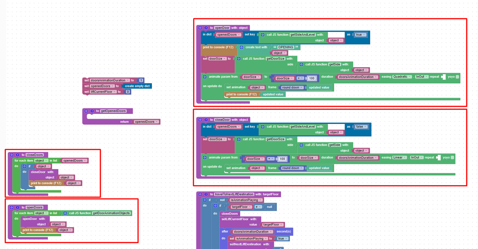

Participantcan you post a screenshot of your puzzles?
I did not get what you exactly need from my puzzles. I posted a screenshot in my last reply.
Here is another one with the puzzles that will play the animations in my scene

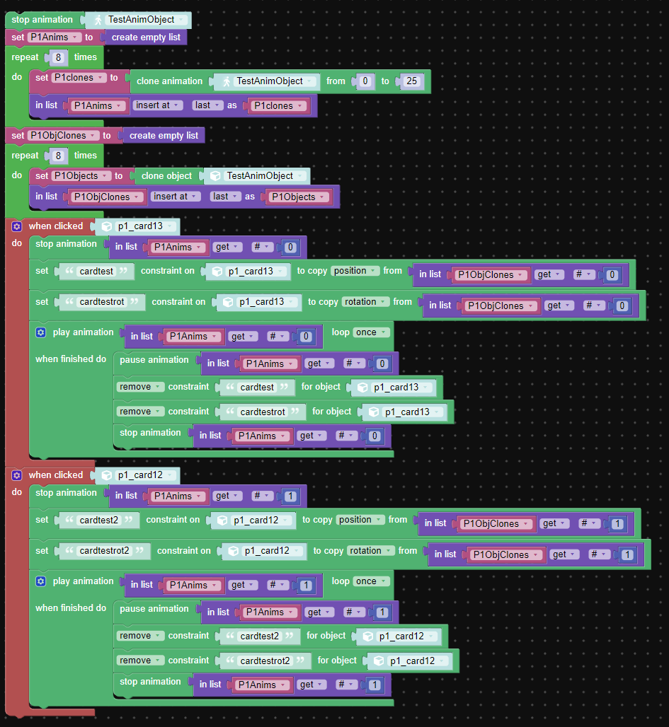

Is this fixed? i have same problem with animation cloning and using cloned animations for multiple objects…i’m cloning animation clip stored it on a list, then calling animations and only first one playing it.
