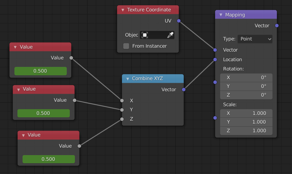

    I use animated texture using Texture coordinates node and Mapping node, and it worked in Blender. But when I do a sneak peek using Verge 3.0.1 the animation is not working anymore. What is causing this and how do I make the texture (the road and mountains) move in Verge 3D the way it did in my Blender scene?
    I attached the video and the texture nodes in this post. Thank you for your time.
    #26008
    animation is only supported for Value and RGB nodes. In Blender 2.81-2.82 you can do the following:
