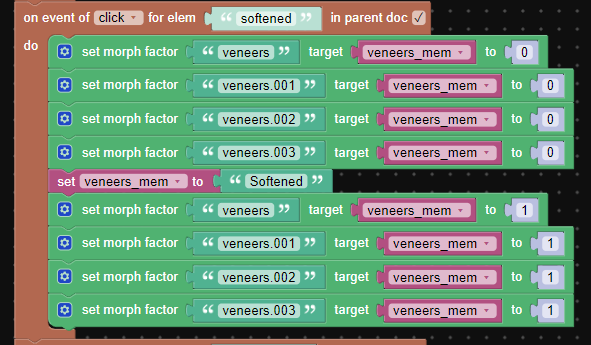

    Hello,
    I would like to know if there is a way to get all objects of my scene that begin with the word “veneers” instead of manually selecting them (see picture)
    I tried to replace the text by the “all object” puzzle piece but it does not work.
    Any help/idea appreciated =)
    Thanks

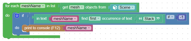

    #65858

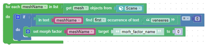

    #65864
    aortalab
    Thanks for your answer but I try to make it fit in the “set morph factor” puzzle piece, and I can’t figure out how to do that.
    #65865
    It’s so hard to replace “print to console” with “set morph factor”? :wacko:
    #65872
    aortalab
    It works great, thanks a lot!
