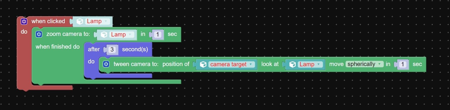

    I use puzzle to zoom camera to an object.
    zoomCamera(‘wall001’, 3, function() {});
    After 3 seconds, I want the camera to go back to its original position. Like nothing happened. Is it possible to do this?

    Made a quick example,but this is how i am doing this with a static camera.

    derekwang0605
    Thanks a lot! Worked very well! :good: :good: :good:

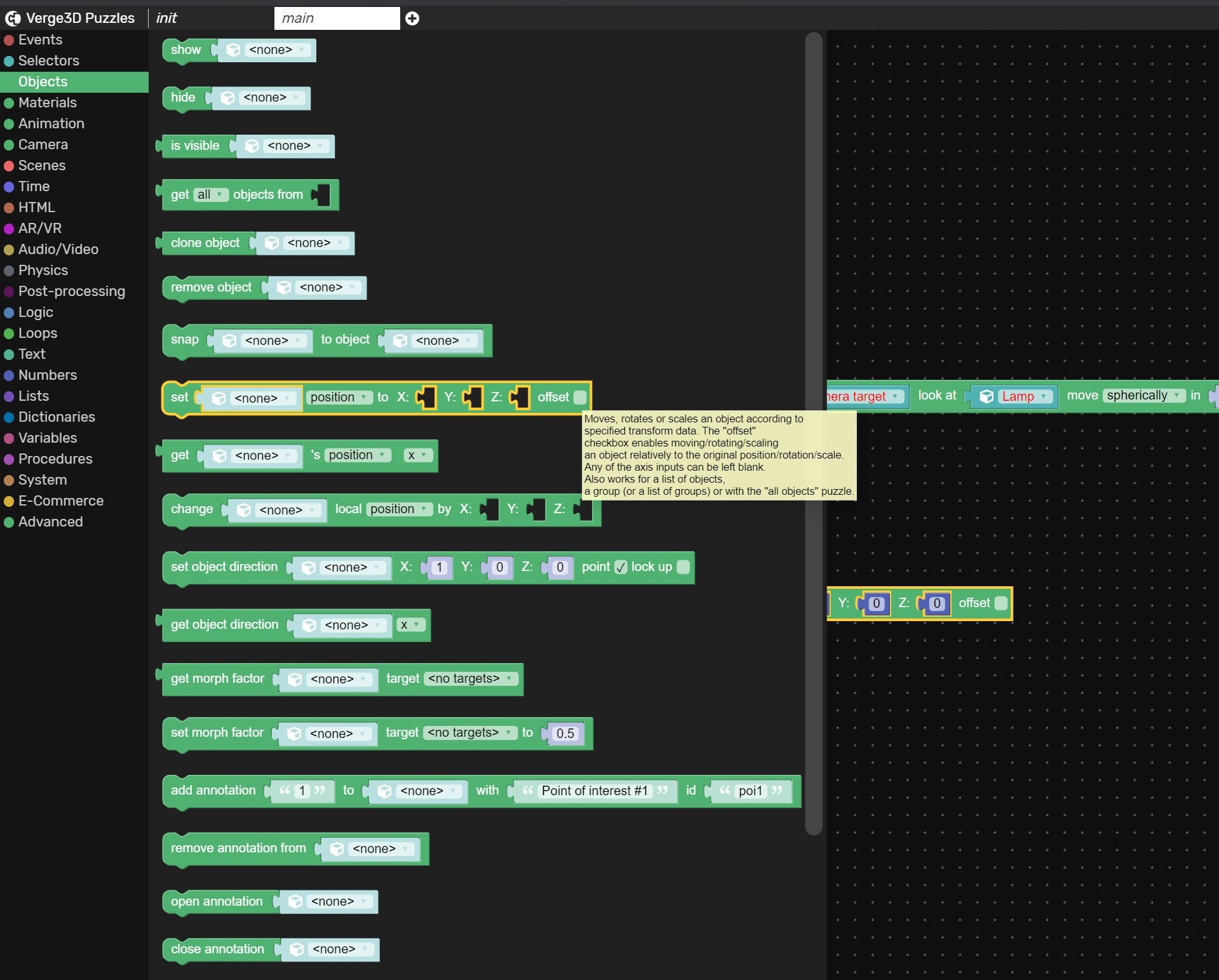

    I also tried to setup the camera back to the original position after all the animations by below, but did not work. Camx/y/z are the position variables I saved from the beginning.
    camera.position.x=camx;
    camera.position.y=camy;
    camera.position.z=camz;
    //camera.update();
    camera.updateProjectionMatrix();

    maybe by using object position puzzels?

    Still not working yet! This can not be impelmented by puzzles?
