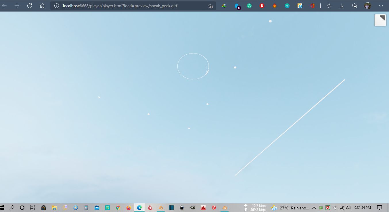

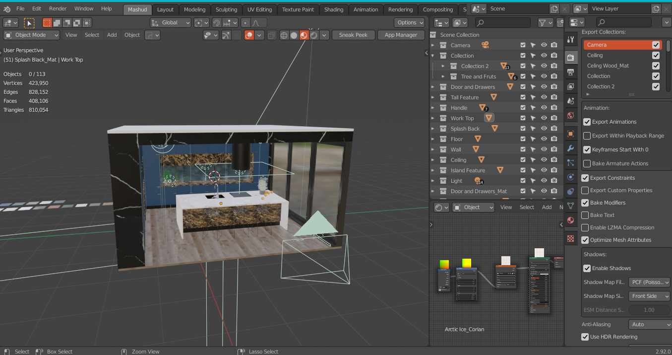

    Hello,
    I’m facing a new problem.
    When I sneak peek to display my architectural model in a web browser, nothing is visible in the browser. How to fix this problem?
    I’m sharing my project screenshort.
    Mashud Rana

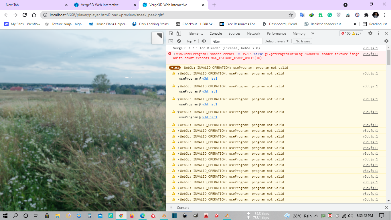

    #42483
    mashud008
    Thank you, and thanks for your information. But I can’t fix this problem. I share my consol error screenshot, please help me if you know.

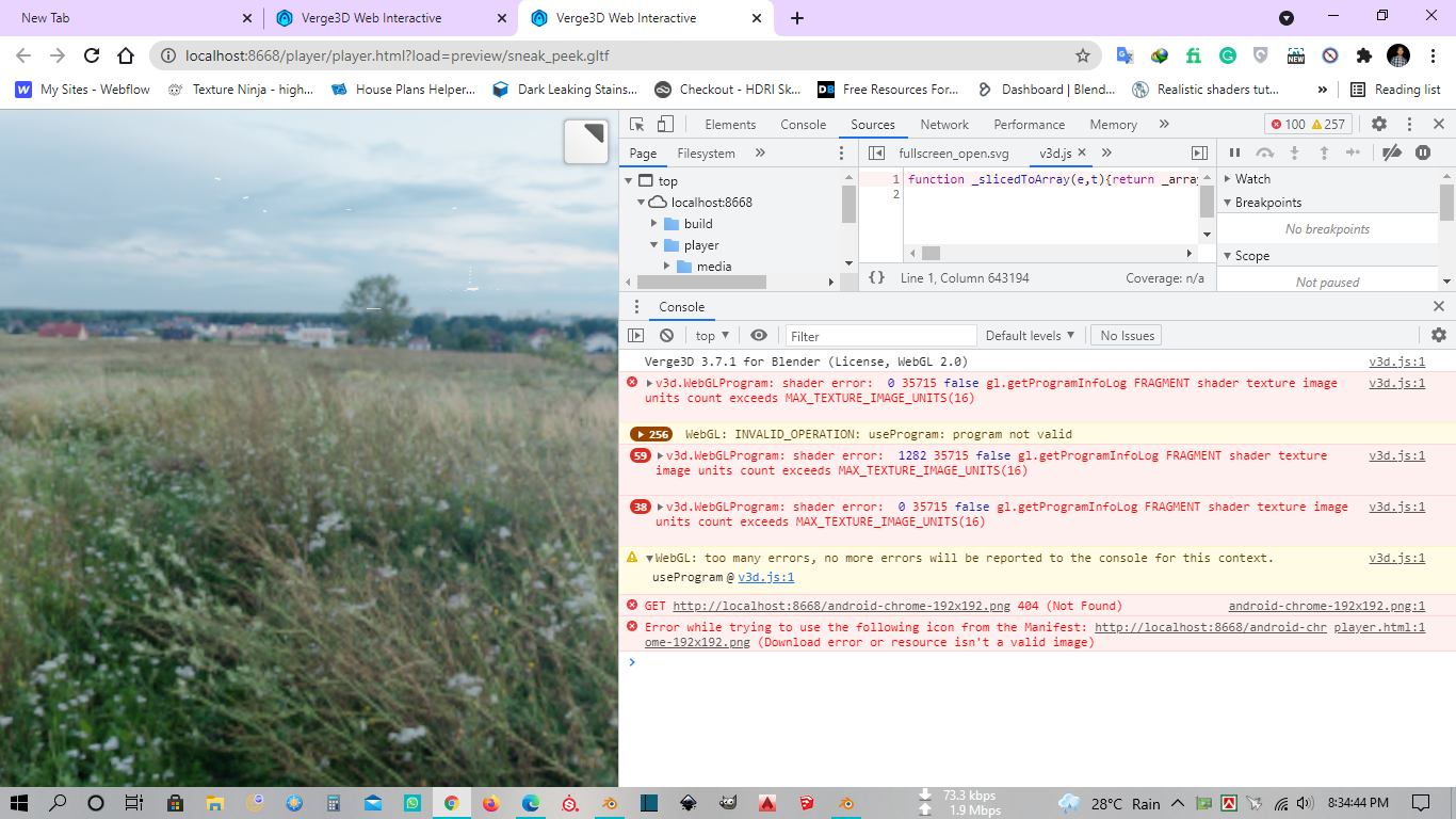

    #42495
    Ok…wow…you have a lot of errors listed in the console.
    100 red – critical
    256+ yellow –
    Typically there are only 3 yellow… 0 reds.
    There are alot of possible reasons this may be happening. From what I am reading it sounds either path or security related.
    I would start a new project in verge3d. Dont worry about using your 3D editor, just see if it will play without errors in the App Manager.
    If it doesnt, you will want to re-install Verge. You should not have any red errors and maybe 3 yellow errors.
    I would also test a default project from you 3D package and open it up in SneakPeak. You should also only see 3 yellow errors.
    If you have issues here…I would reinstall Verge3d.
    Now…if you made it through App Manager and Sneak Peak and got the desired results…its now scene related.
    From the console errors it seems you have texture files it can not find locally and are throwing 404 errors. You also have textures that are out of limits and they too are just crashing out….so with enough of these errors…the page just wont be able to load.
    If you are using Blender I would be happy to take a look at the project file and let you know whats going on.

    #42511
    Hi Mashud00,
    I have reviewed the scene and found the issues. I have sent you an email detailing how to get the scene to appear as well as steps you can take to optimize the scene.
    Let me know if you need anything else.
    -Xeon
