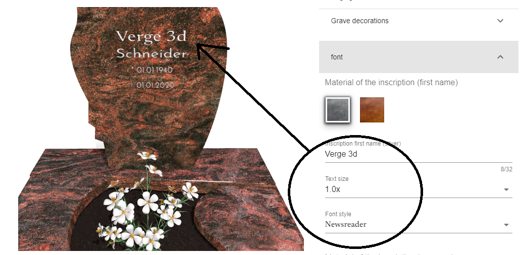

    how do I add text and change its font and other characters using verge, like attached below for reference?
    I know it’s a combination of puzzles and blender. however there are no tutorials or any literature where i can learn to do such stuff.
    If any one can give link or just guidance on how to do it, it would be great.

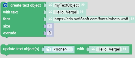

    The easiest way is:
    1. Create your text as a Blender text object(s).
    2. Verify that “Bake Text” is NOT enabled on the Verge3D export settings.
    2. Use the “Update text object(s)” puzzle piece from the Objects tab in the puzzle editor.
    Alternatively, you can create a new text object with puzzles directly. That puzzle piece is called “create text object”.

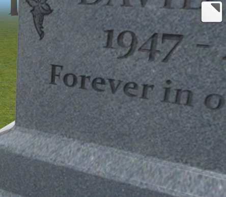

    Both of the techniques above result in flat text like you show in your screenshot. Obviously, text on tombstones is engraved. You can achieve this look with a custom shader. I have attached a screenshot from my project.
